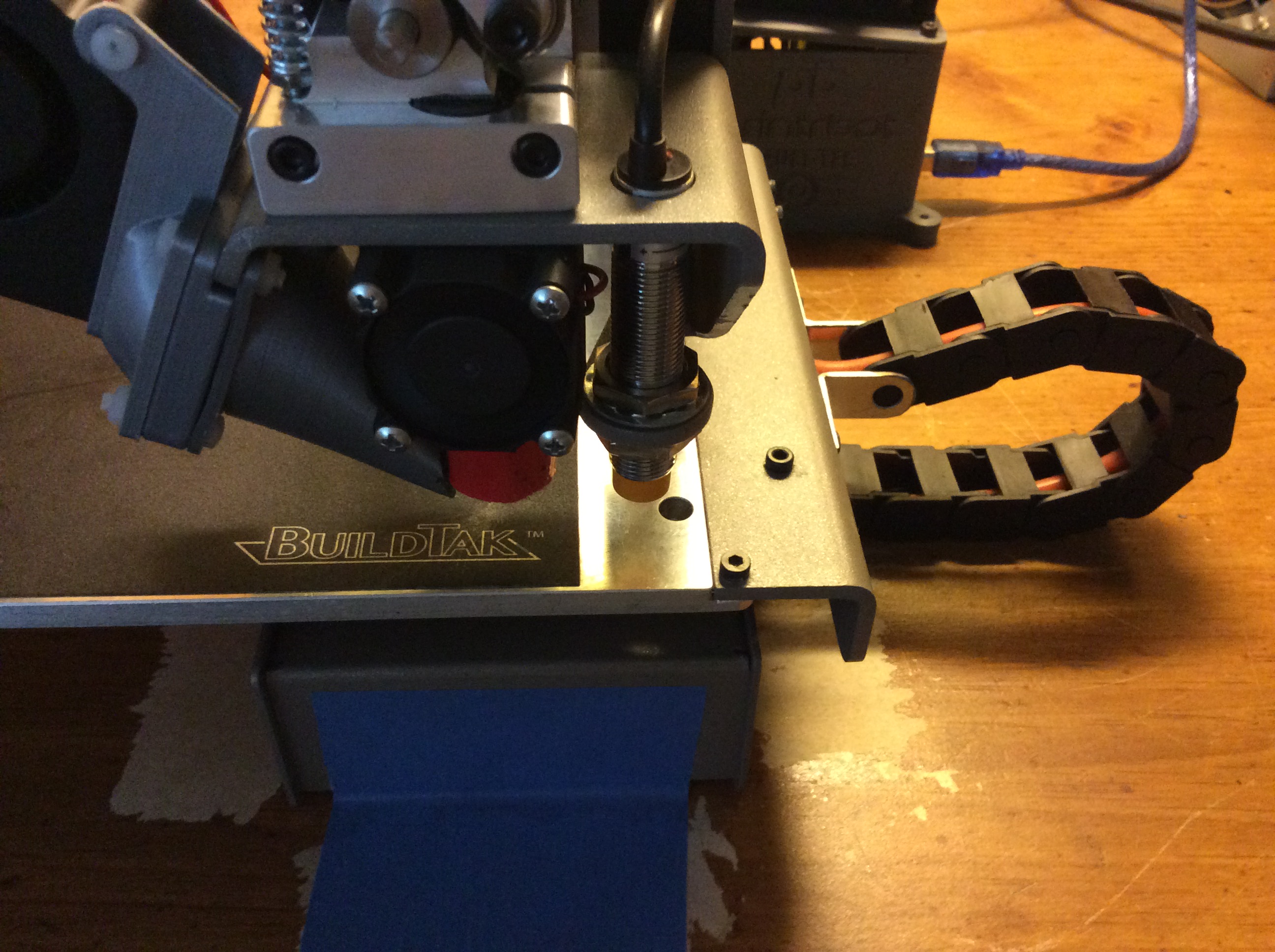

I have torn my Simple apart a number of times to check rods, the build plate, you name it. But recently I was watching my printer to ensure that all important first layer when I noticed something I will be fixing this week. I use BuildTak, and most of us have used the blue tape or some sort of masking bed prep to achieve adhesion and maintain our investment. Well it seems my print bed, and many I have spoken with report the same, is low on the home side (left) and high on the right side. Our printers use an inductive sensor to measure the z height, which is located to the right of the hot end and most of us only mask off the needed print area so as to not be wasteful with our materials. With the 3 point probe the first two points have that masking material below the inductance sensor. This bed prep material to an extent insulates the metal bed underneath it much like rubber insulates electricity in an appliances power cord, which causes the sensor to get closer to the prep material as the first to points are probed. The third and last point, as you can see in the photo, doesn’t have that insulating material blocking the sensor under it so it picks up the flux field at a higher height and adjusts the three point plane to seem as if it is skewed even though the print itself will be on top of the bed prep material and slightly higher than the point that isn’t covered and triggered the sensor more easily. The whole thing skews the entire print plane even though the bed may be flat, and the skewing is exaggerated by the thickness of the bed prep material plus the additional height that the uncovered probe point triggered higher at.
I ordered a piece of PEI that is 9.25”x6.25” and will use it to cover my whole heated bed, probably trimming it down to about 8.5”x6.25” so that each probe point will have roughly the same inductance potential and register with the sensor at reasonably the same heights. I hope this sorts out the skewing of the print bed, cause I really don’t think it is that far out. As is now a print barely adheres on one side while being smooshed completely flat on the other side of the print bed, so smooshed sometimes it clogs my hot end momentarily.
Those are my thoughts on why the bed seems warped.
