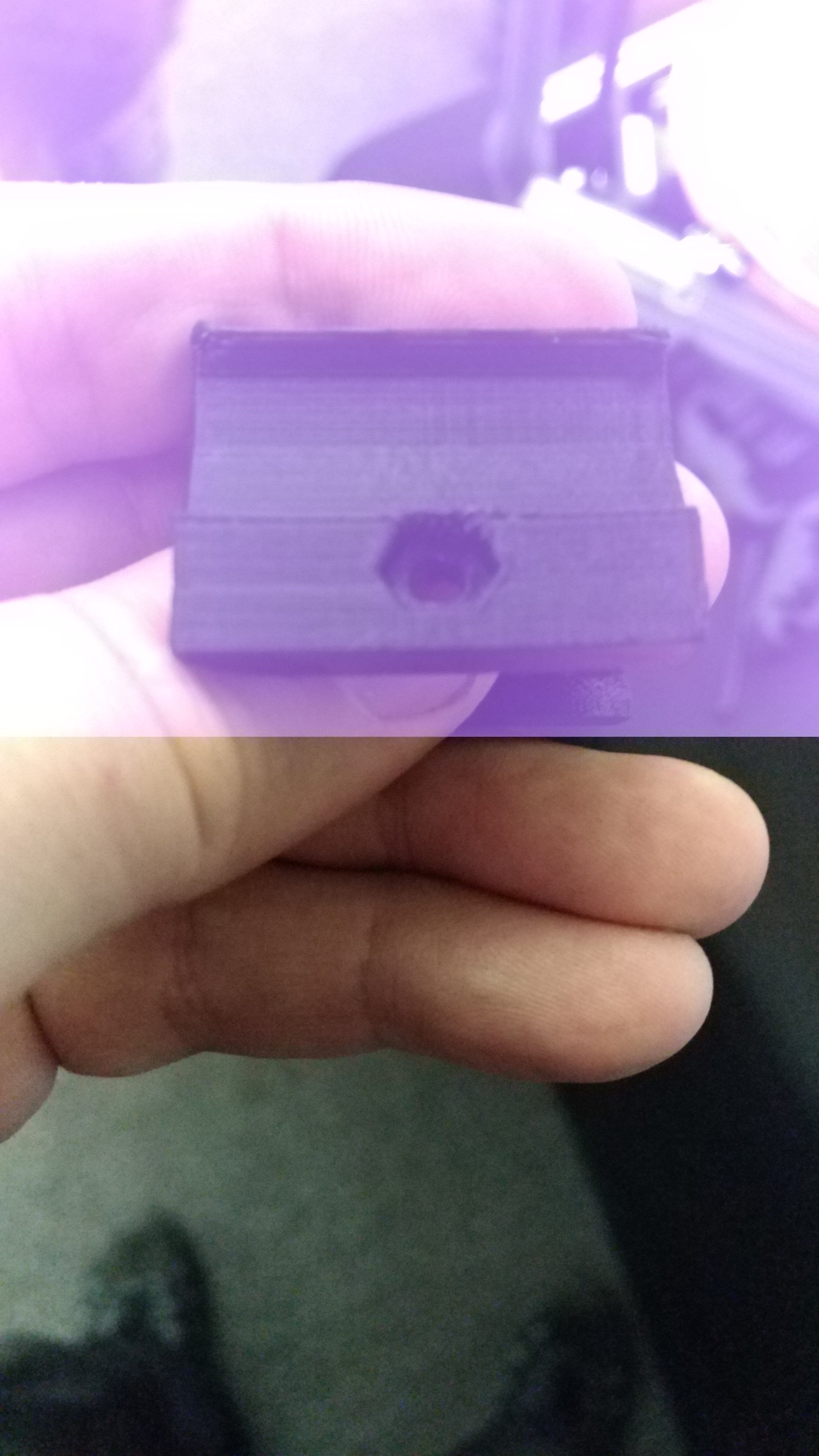

Need some help
It seems my setup prints compressed.
My X and Y work well
The Z seems 90% of the proper size.
These are my settings.
Any idea why or how to fix this situation?
Thanks
Need some help
Thanks
As long as you’re not doing XY compensation, I’d check you’re calculated steps/mm on the Z axis.
If you’re using M8 threaded bar as a leadscrew which many people are then one full rotation is 1.25mm whereas M6 is 1mm. Hopefully these hints will be useful.
That’s not a slicing issue unless you scaled the model only in one axis. Check the steps/mm in your config/firmware
OK I will check this out today. Thanks
BTW my system is a Delta not a caetesienne
@jeremie_laflamme In that case, I’m just guessing but what pulleys and belt are you using?
