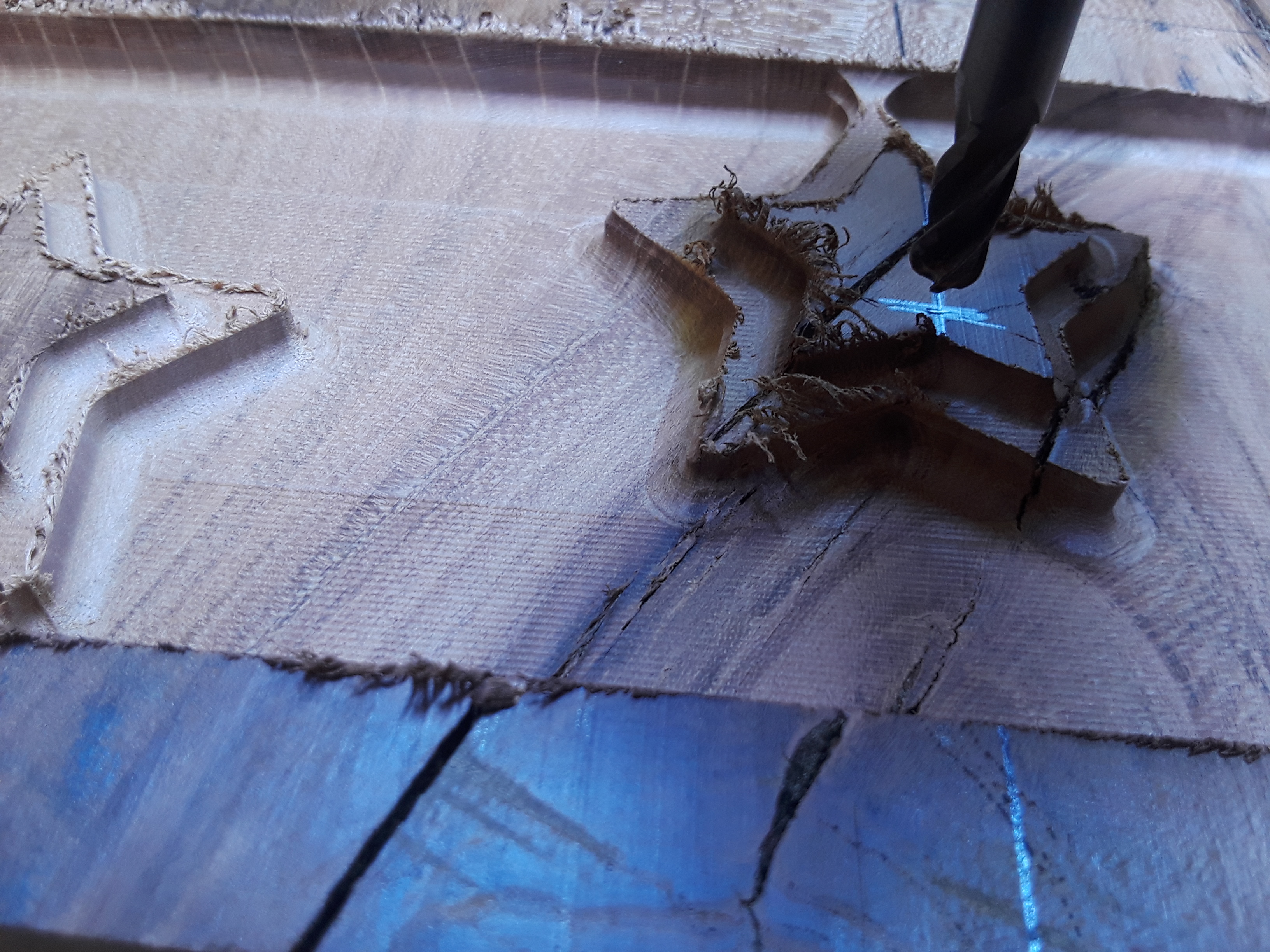

@Ariel_Yahni_UniKpty Here is a photo of the roughing pass. It seems to mainly on the X Axis. Mark center of the board. Set HOME to that center, after rough pass finishes returns to home, but the bit is about 1/4 inch to the left of center on X Axis.
@Michael_Durie You should have each stepper driver power input wired directly to the power supply thru 5A fuses. Do not daisy chain driver power together, run separate wires to the supply for each driver. I wouldn’t recommend taking driver power from the controller, because you could be drawing almost 12A if all 4 motors are running at once, who knows how thick the traces on the controller board are?

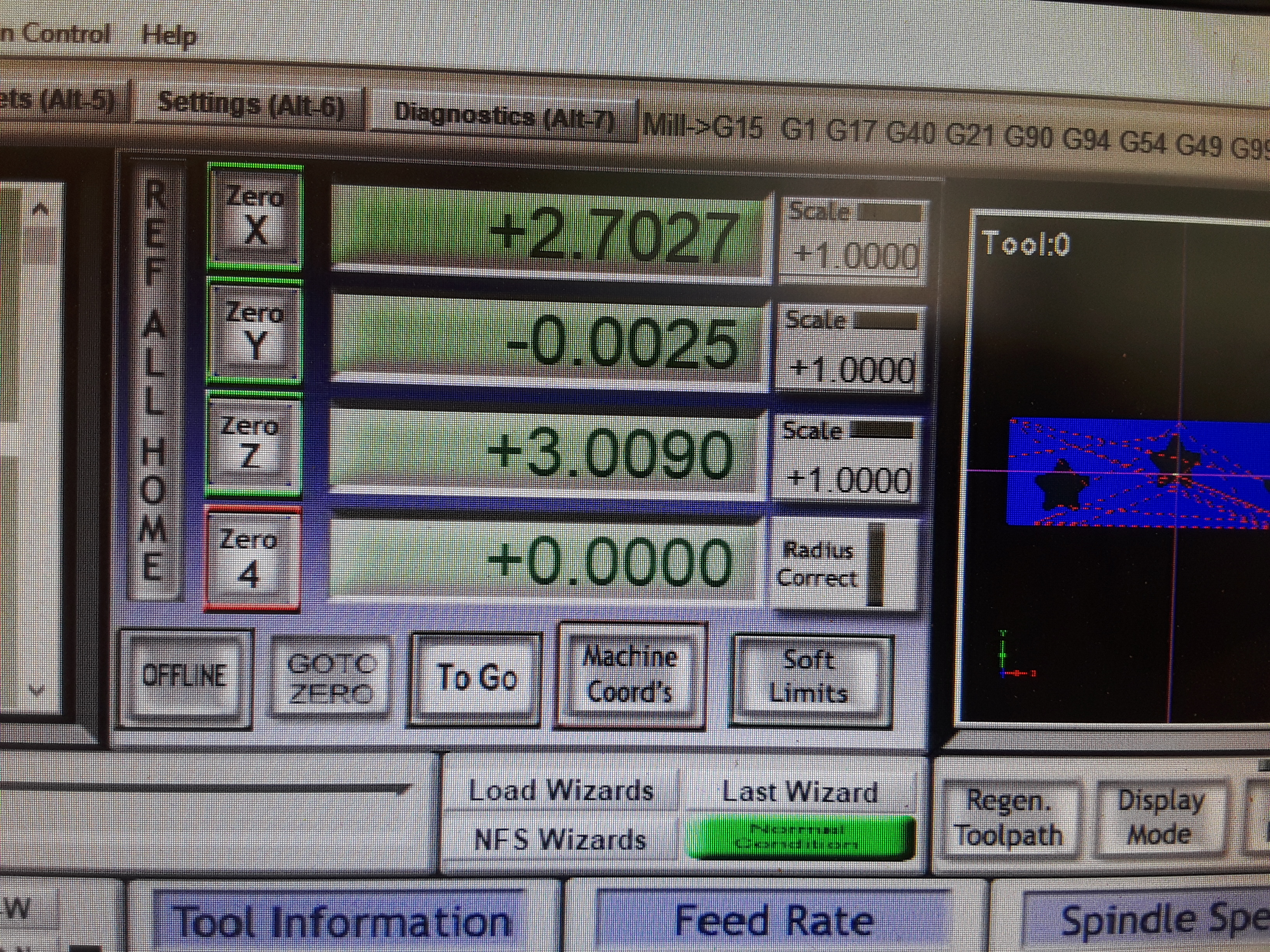

From what all tests indicate, is that its on the X axis after the rough pass finishes. It should return to 0,0,0 (home) and when it returns its 3mm to the left of the mark on X axis. Y seems accurate. On just a simple toolpath test, it returns to 0,0,0 without issues multiple times.
I will see if I can find the WD40 Dry Lube locally.
Double check that there is no play in the X axis carriage. You will typically see problems only when the carriage reverses direction, this is when any play in the axis will reveal itself. Strange that it is exactly the same distance every time, and that it is farther than the axis was supposed to move. I would have expected it to be less. That is not consistent with losing steps, it is more indicative of play somewhere in the axis.
Check your flex coupling on the motor to see if one of the setscrews is loose. Check the leadscrew nuts for play, and the lock collars on the ends of the leadscrew.
