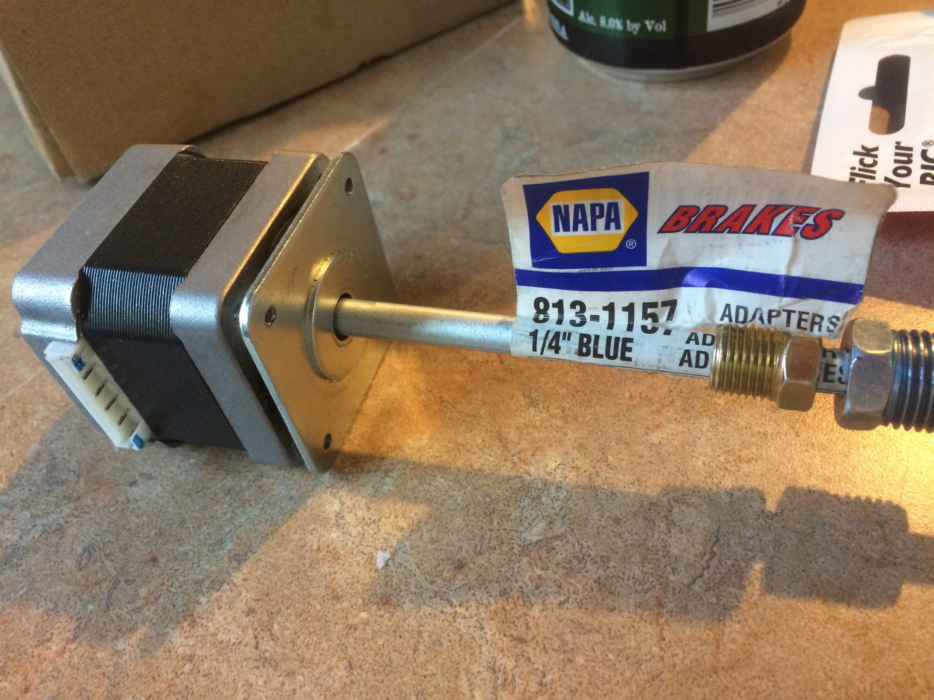

Need spacers for your  extruder? Napa's got it.
Need spacers for your #saintflint extruder? Napa’s got it. 1/4" Brake line, with a little convincing with a drillbit, will work for ya.
+50 for inventiveness.
Let us know how it turns out. Interested in hearing from someone who isn’t @shauki or @Mauro_Manco .
Oh, there’s definitely something there. It’s a PITA getting the flint wheel off the lighter, but it’s grippy, and the dual path of the extruder meant it’s moving well with reasonably light pressure. The in-and-out on the same side of the extruder and the length of the bowden are a little bit of a hassle, but I can see the potential.
