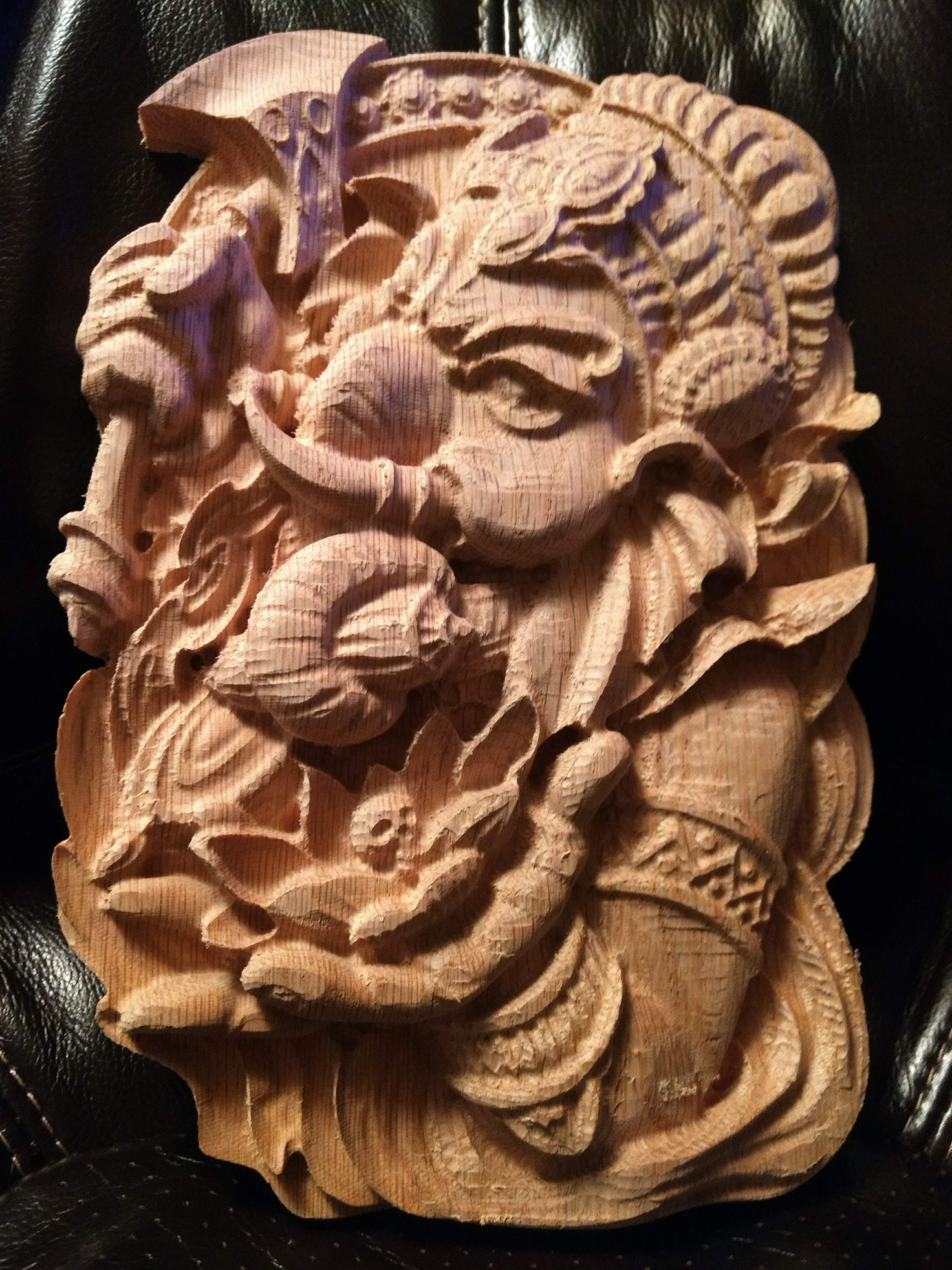

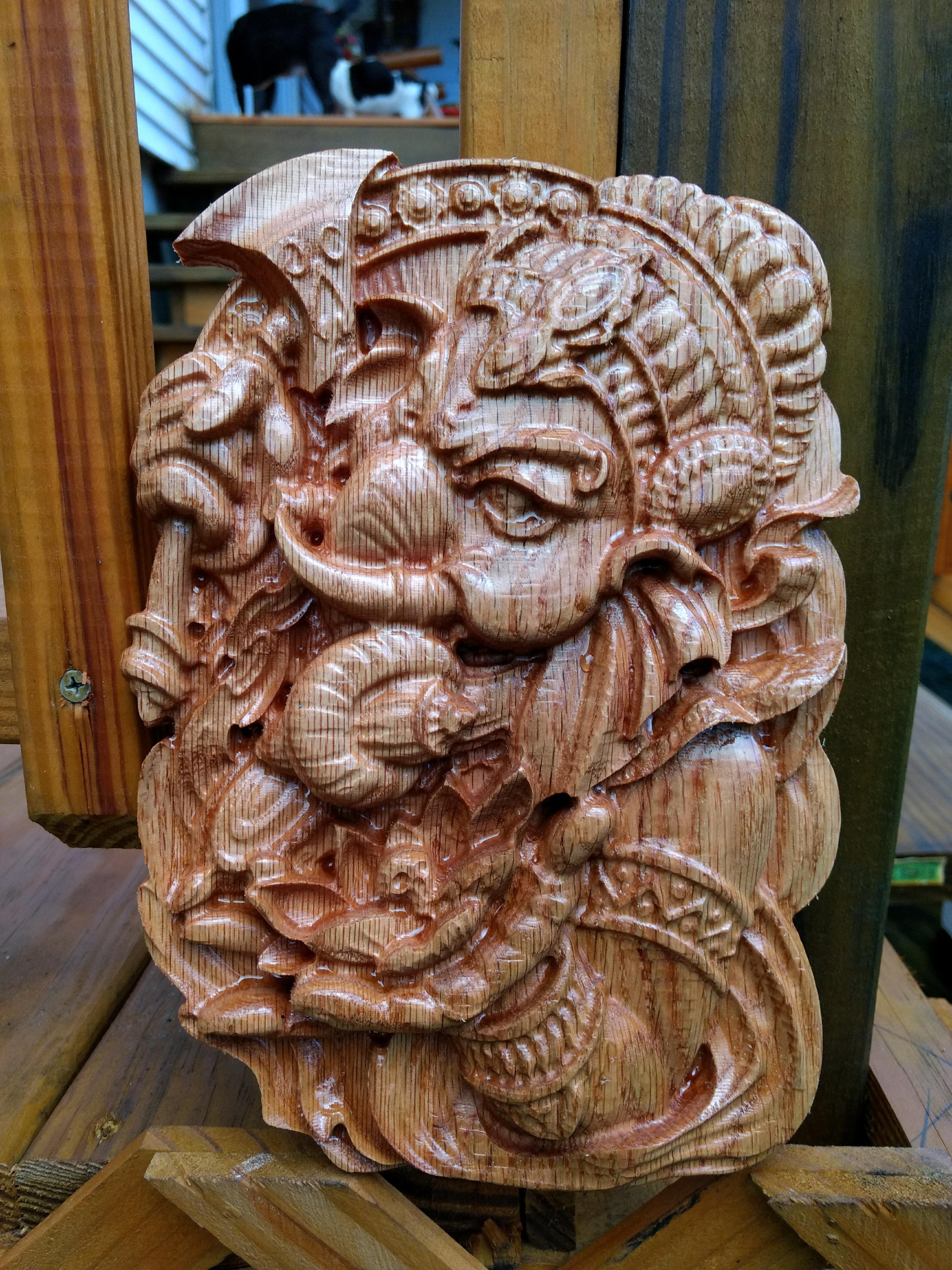

Need to do a tiny bit of touch up sanding. Can’t wait to see it with a coat of poly.
That is amazing work! Are you doing the designs yourself, or where are you getting them?

That looks great! What bit and speed are you using?
@Michael_Forte Thanks. I’m using a 1/4" up cut 2 flute end mill for roughing pass. 1/8" ball nose for finish @ 60 IPM. I never reach speeds even close to that though because of all the details in the cuts. The step over is 10%. A long process, but it is what it is.
