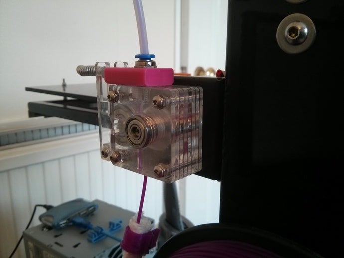

Nema 17 direct extruder block for my 2nd Eventorbot build.
I didn’t get the full kit, so had to design my own extruder block to use a standard stepper motor. This one is laser cut and seems to work well.
Now to get the fan and PWM sorted to get some better PLA prints…

Nice, are you going to share the plans for the extruder?
There are a couple of kinks I need to iron out (the pink block for example) then I’ll put it onto thingiverse.
Nice to see another eventorbot builder. That’s a pretty nice extruder, as I’m sure you’ve felt the sting of the stock extruder. I have a minimalist extruder waiting to be installed into mine, I just need to get around to making the mounting bracket for the Bowden. That is one enormous spool you got there. I bought a 3 lb spoil and unfortunately is was a large diameter instead of length, so it hits the extruder. I finally got my hands on an empty small spool so I’ll end up transferring to that.
