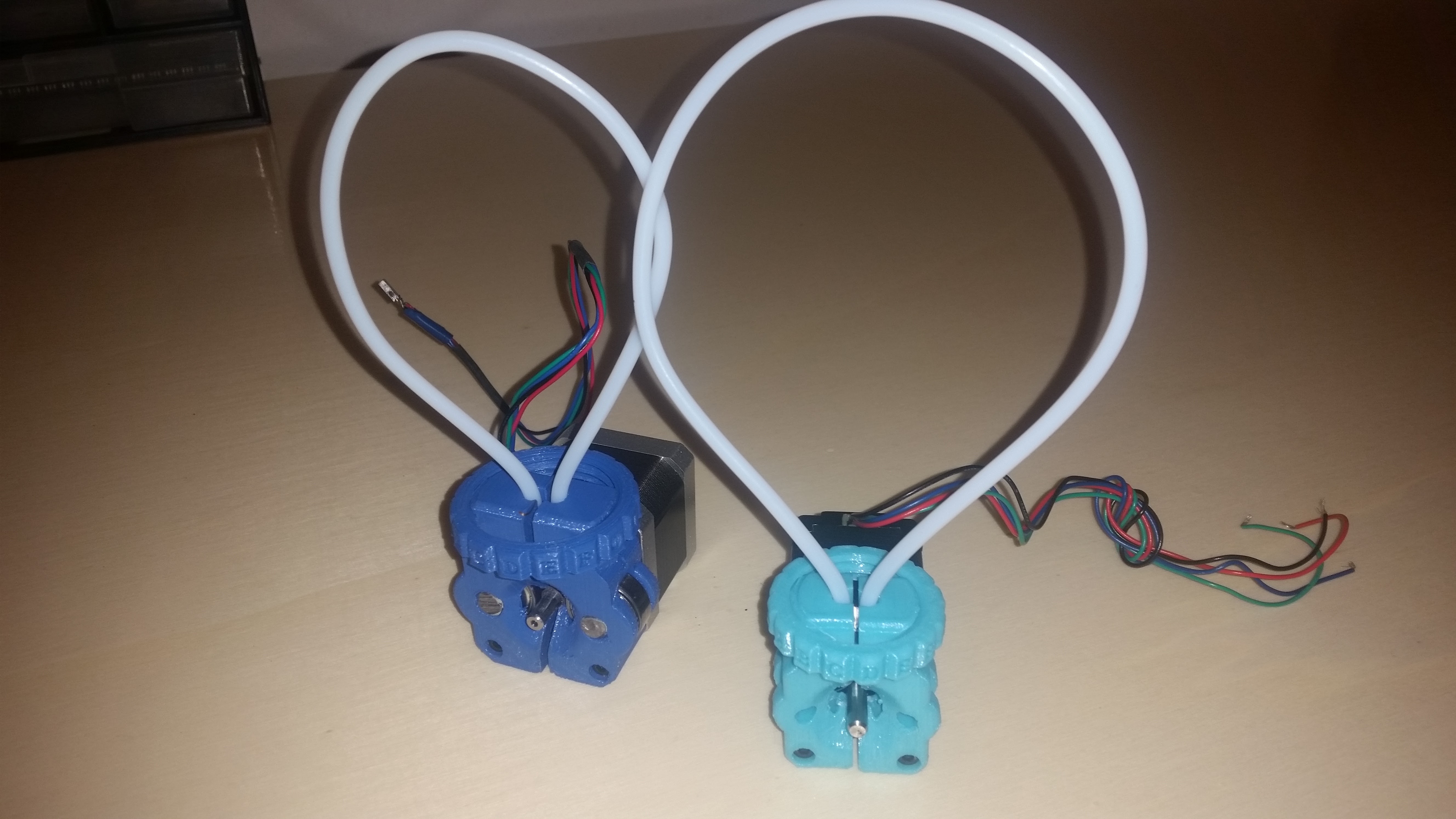

#saintflint nema17 need only 2 625 bearing
Good to see the little brother alive! With those colors, it’s almost like in a candy shop!
A fablab for we person are candy shop
could the NEMA17 version also use 625zz bearings?
No I’m in fault nema17 bearing 608 nema 14 625
Is there a reason why the NEMA17 needs a 608?
Elliot because saint are an evolution of #flintfeeder and him use 608 nema14 no permit this bearing for this we decide to use common bearing used in other project too the 625.

@Elliot_Foster With such compliment, you just won yourself the variant you were asking for… ![]()
It’s not so nice, because the bearing are now flush inside the body of the extrusor, but that’s a matter of taste.
You can have it here (pictures and stl)
