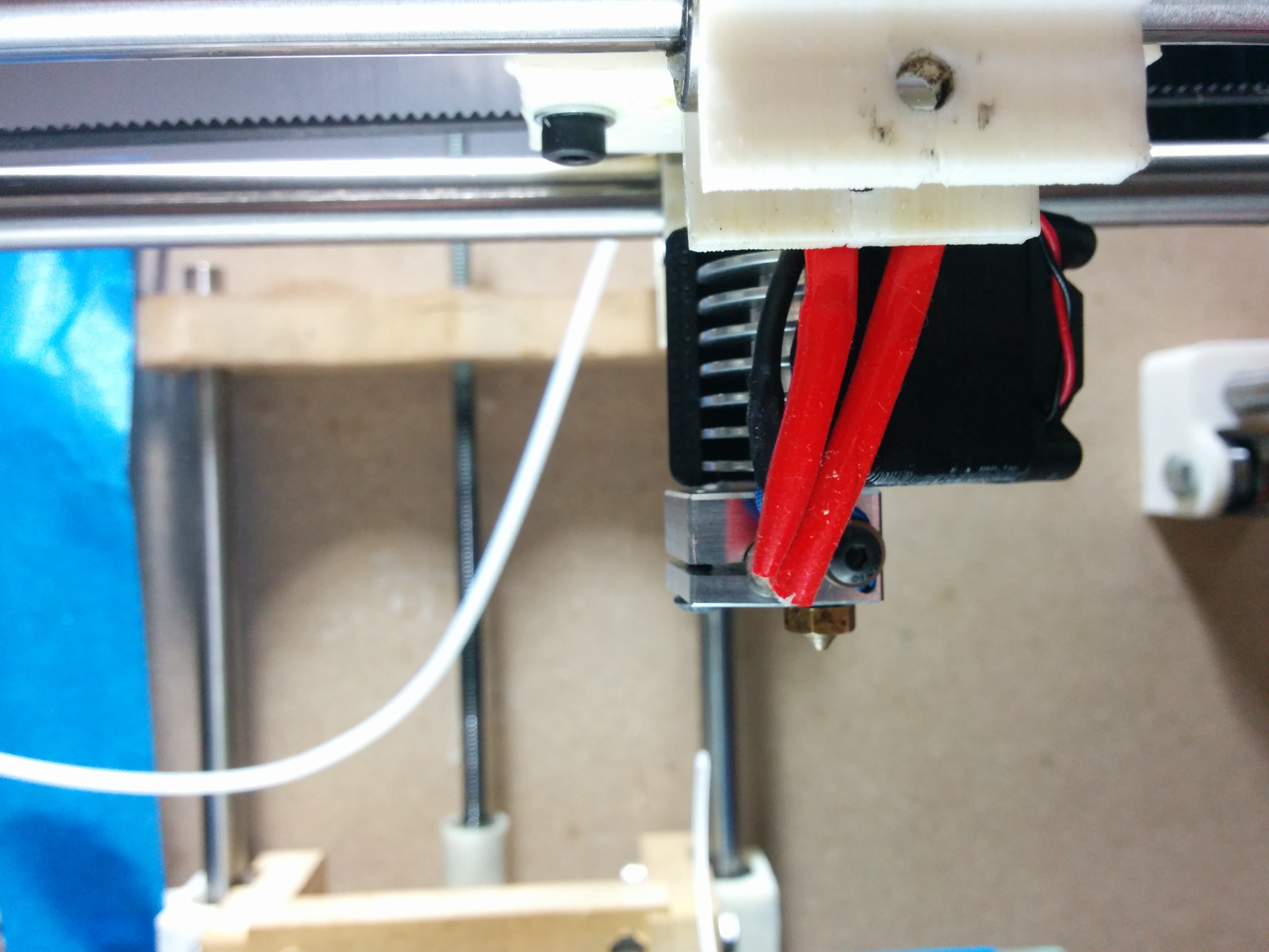

Nemesis back up and alive. Using my e3d v5.5 :wink: the mod worked well and the printers back to production. I really like the new heater blocks.

@Joe_Spanier is the heater block flush with the fins, or is this my eyes playing tricks on me ?
V6 heater and nozzle on a v5?
That’s the camera angle. And its totally a v6 heater, block and thermistor with a v5 break, nozzle and heat sink. I’m converting my other v5s as well.
