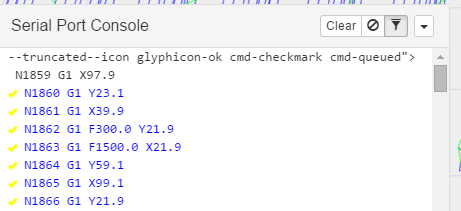

Nerved issue, maybe somebody can help me. If i start a job after some minutes i get this here. If i recheck the chebox at my COM port then i get the errormessage: “Error opening port …” I guess the tinyg are to hot and lost serial communication? I have no errors in JS Console.
Here some additional informations. The console from SPJS wrote this error:
