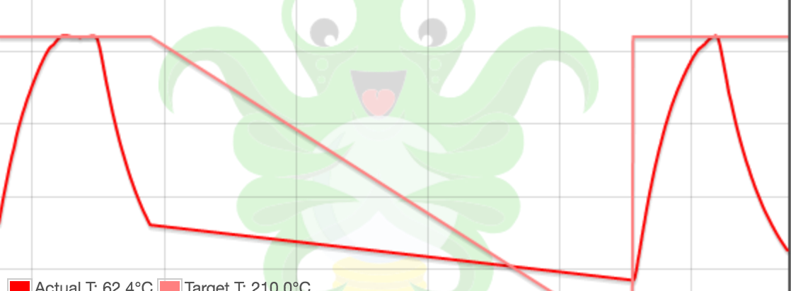

Since I last checked in, new heater cartridge has been installed, Polyfuse has been swapped for real slow-blow 5A auto fuse, Marlin firmware has been re-downloaded, spare power supply has been swapped in.
And it’s still doing this. :frowning:
(Peak one was on old 350 watt power supply, next peak was from known good 480 watt power supply.)

Man did it again. Mark this down, I’ve replaced everything except the thermistor and the wiring loom from the top to the controller…I’m betting thermistor
What is significative is that both shutdowns happen at the same temperature. So I bet it is a thermal shutdown on your firmware. I cannot see the temperatures scale though (to see what temperature is causing this.
However, let’s assume that is the case. It may or may not a thermistor problem. If the termperature is too higher than you commanded, it may be the thermistor is ok but the mosfet switching the hotend resistor is dead in a shorted state (not uncommon) so your hotend starts to heat it up as soon as power is applied (this is easy to be ruled out though: apply power and see if temperature raises without you asking it so).

This is probably not a maxtemp issue because OctoPrint would actually disconnect in such a case (error from the firmware) instead of happily continuing to poll the temperature, and on the first attempt it also stayed at the critical temperature a short while before dropping off.
