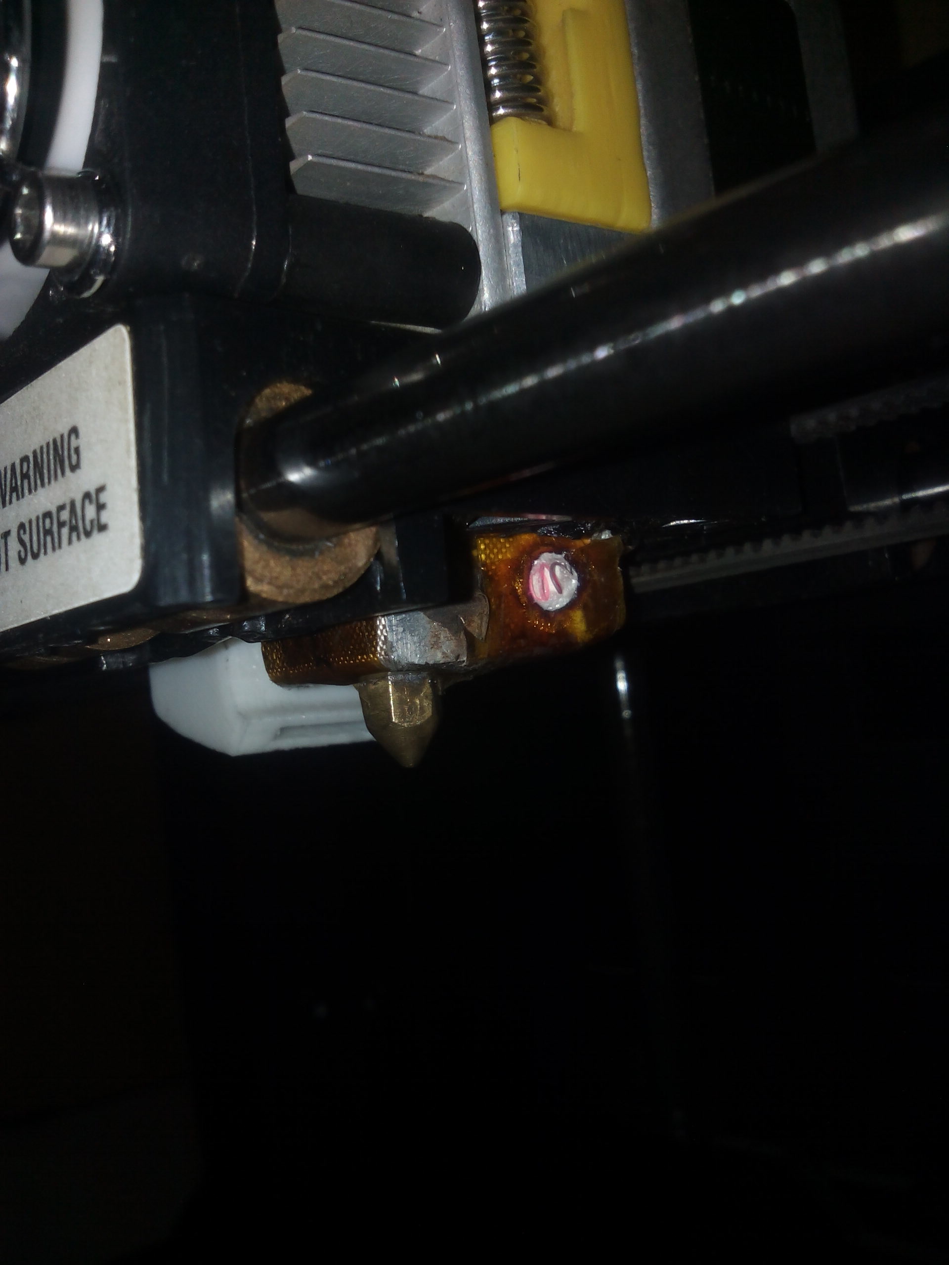

Never showed this to anyone before, but here it is,
Never showed this to anyone before, but here it is, cheap and low tech (and more reliable but burn hazzard) hot end, 2yrs running with no jams, heats up about 30secs to 230 (overshoots 240), on makerbot Replicator 2
What are you showing actually?
@Krasimir_Nikolov ​​ hot end heater, ceramic coated, easy to build, 1st photo (with flash on) shows where I installed it, 2nd photo (no flash) shows how it lights up like led

@Sebastian_Schmidt yes, it is homeBuilt, I discover that in the first few of NiCr wound, from thinner ceramic and thicker cores to thicker ceramics and thinner cores, the gap between coil wound is essential (from my perspective) tight and touching gets more faster heat and save more space, I made mine from an eletric stove NiCr wire (AC), tried some with other gauge, but 29 is working good
@Aria_C_Bramanta what are you using for the ceramic ?
I am using wet ceramic clay (powdered) Don’t know about the exact composition but it can endure up to 1000 degrees (or so I’ve been told), but any ceramics will do I guess
