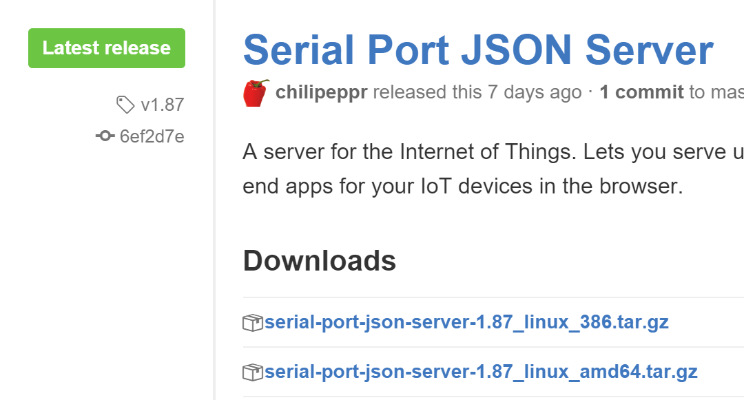

New 1.87 build of SPJS released for Linux & Windows.
New 1.87 build of SPJS released for Linux & Windows. Has the terminal and NoceMCU changes in it so you can better interact with your devices. https://github.com/chilipeppr/serial-port-json-server/releases
