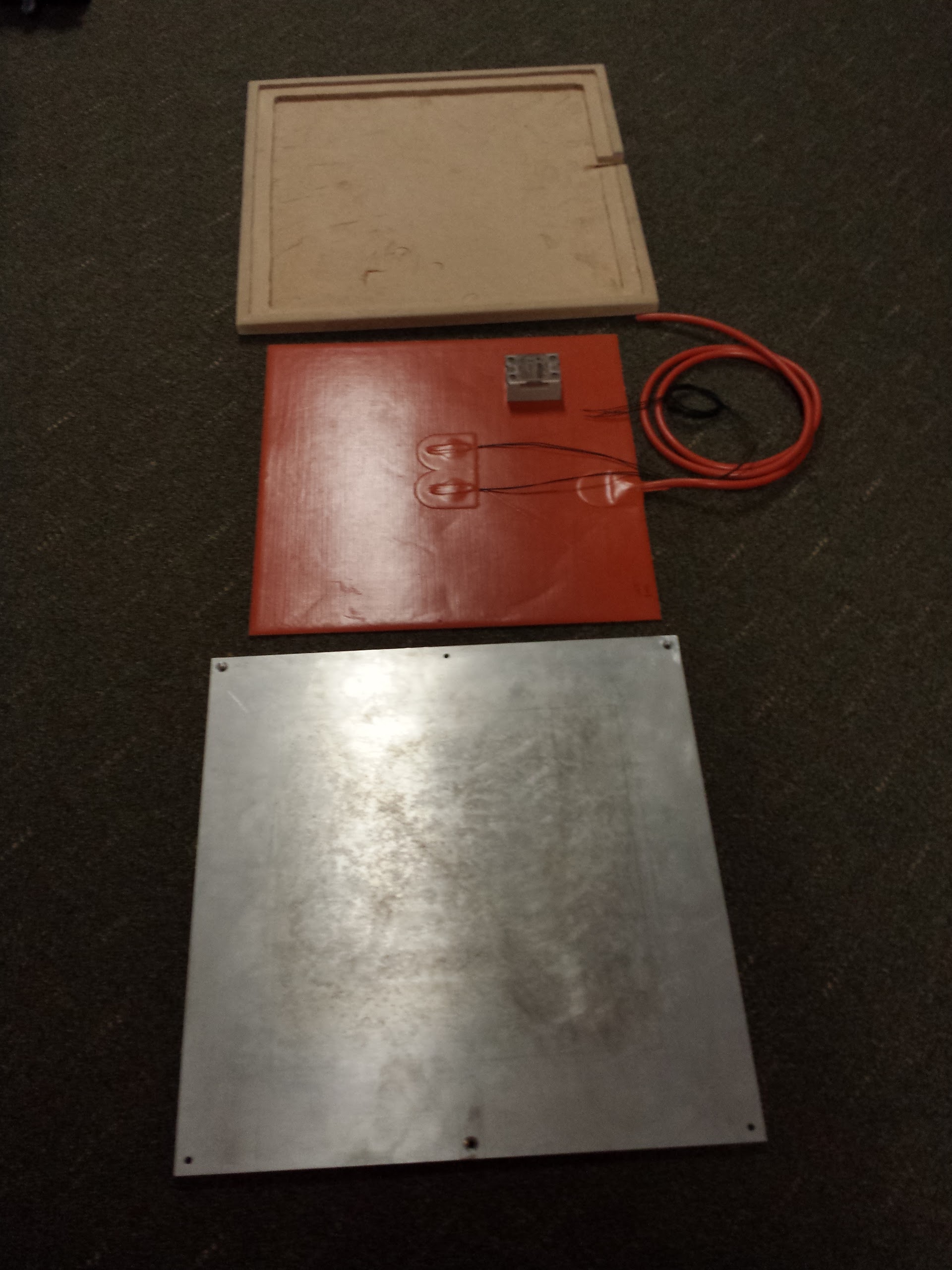

@Eclsnowman Unless you have borosilate glass (high temp glass like stove or a car window) to many watts/in² could result in glass shatter if the temp is ramped to fast, you have to ajust the firmware to compensate.
@Wayne_Friedt at first I was thinking just as a backup for failure then I would just swap leads. But if anyone knows how to use two: one as primary and one as a backup(check for a difference) I am all ears.
@Eclsnowman Ah i see. I have had that happen before where the thermistor stopped working and i just stuck another one under the bed. Works fine. Cant tell any difference if there is any. One thing as i suspect you guessed is anyway you wire those two thermistors together will change the resistance.
@Wayne_Friedt the azteeg x3 has plenty of extra thermistor inputs. I just don’t know how to handel it in firmware to use one as a watchdog for the other.
