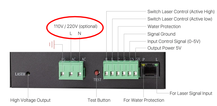

incorrect wiring?
long wire runs?
wrong gauge wires?
ill include a wiring diagram.
