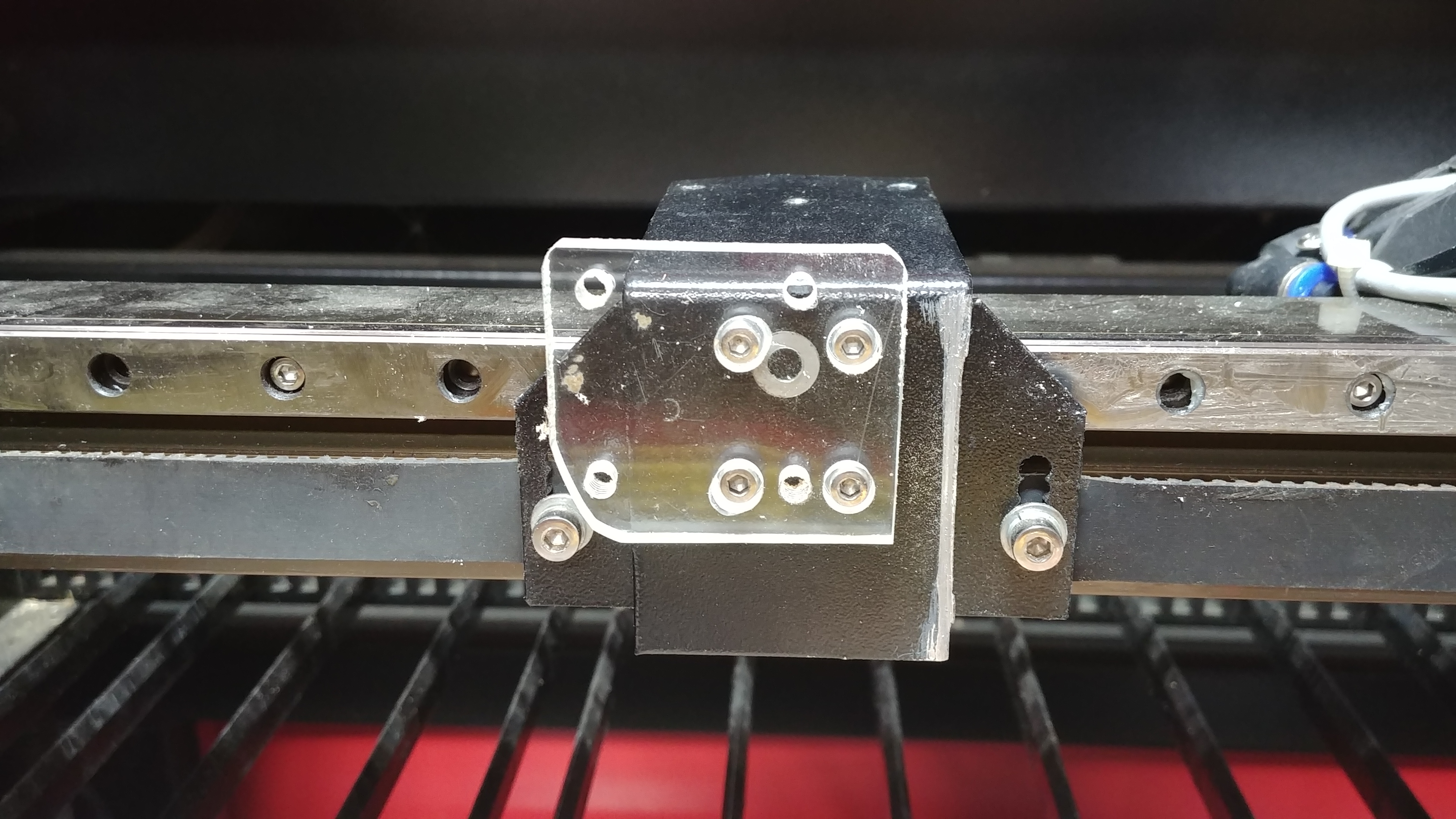

Ordered brackets from Russ, bought acrylic and made the heads.
Started with install on my k50 and needed to mod head to raise mirror by about 8mm. Luckily I had access to a second laser to be able recut a new head with modification.
Once complete I installed and was delighted with performance. I went to install bracket on China red and discovered the mounting holes where not the same despite the head looking exactly like the other.
Thinking cap on and I fabricated a mounting plate from acrylic as a go between to get the bracket I bought from Russ to be able to mount the new acrylic head.
I hope the pics will help explain and I’m posting to hopefully encourage others to follow.
Again not my design but these heads can be modified to fit other machines then just k50.
