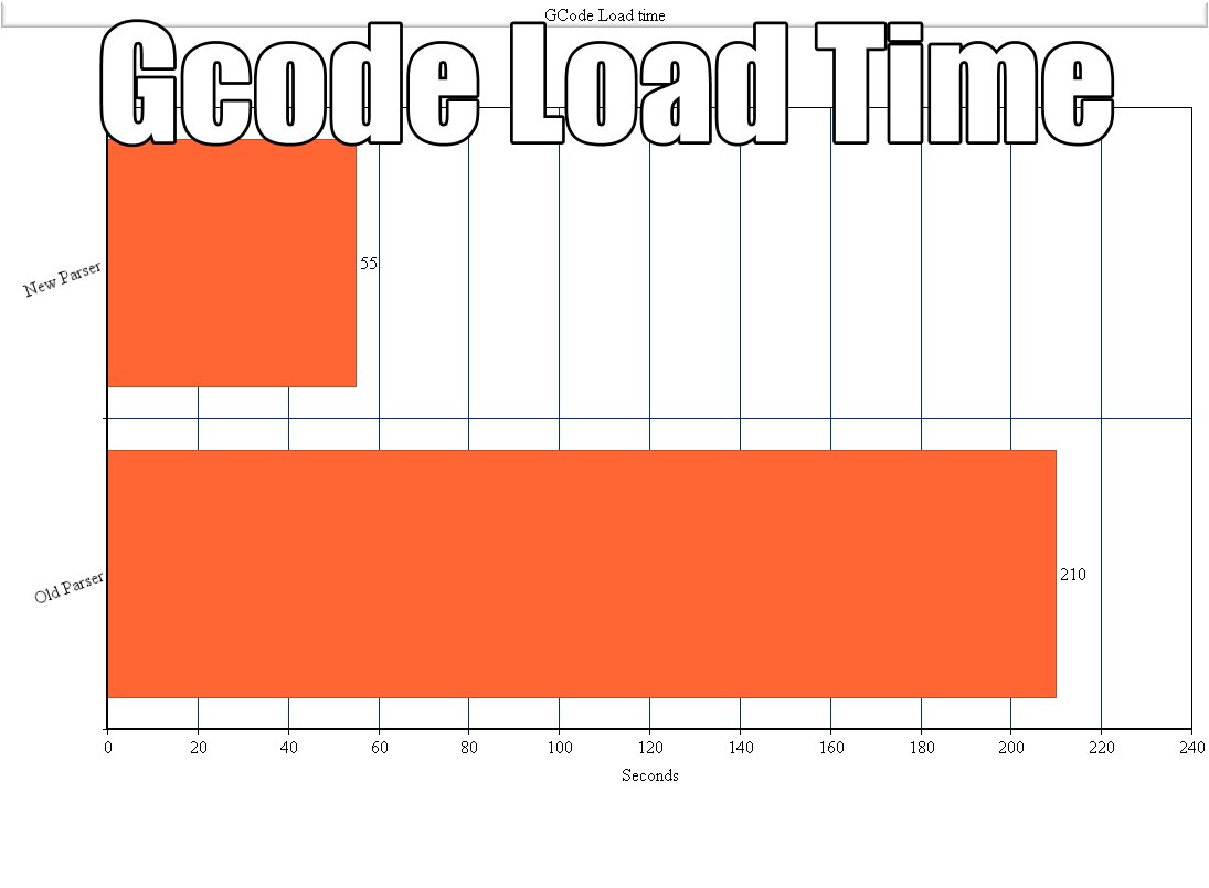

Over the last couple of days I worked on improving the load time and memory consumption, to be able to print larger gcode files.
I have been able to optimize the parser to be up to 3x faster and require 40% less memory. Now, instead of ~210 seconds for 1000000 gcode lines it take only ~55 seconds. Due to the reduced memory consumption I was able to load a gcode file with 4 Million lines.
The new parser is not enabled by default, because it might still have bugs. But you can try it out by enabling it in the options (GCode Parser = Fast)
