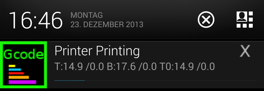

Finally the printing can be done now by an Android background service.
  • Once connected, a service is started to handle the connection.
  • Print jobs will be done by the service, the App itself can be closed.
  • Print progress and temperature is shown on the notification panel.
  • Click on the notification, will open up the App and sync up with the service.
  • Printer connection can be closed by pressing X on the notification (be careful, it will stop your print )
To test, you need to enable the “Printer connection service” option.
