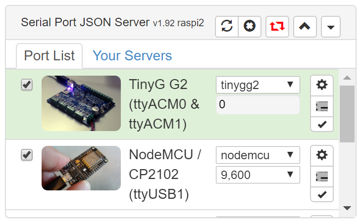

New checkmark button in SPJS widget (in right column under cog wheel / programmer btn). This lets you toggle between two open devices to set the new default device without disconnecting/reconnecting. Helpful when using NodeMCU workspace at same time as a CNC workspace, especially when needing to send serial port console messages to both devices.
