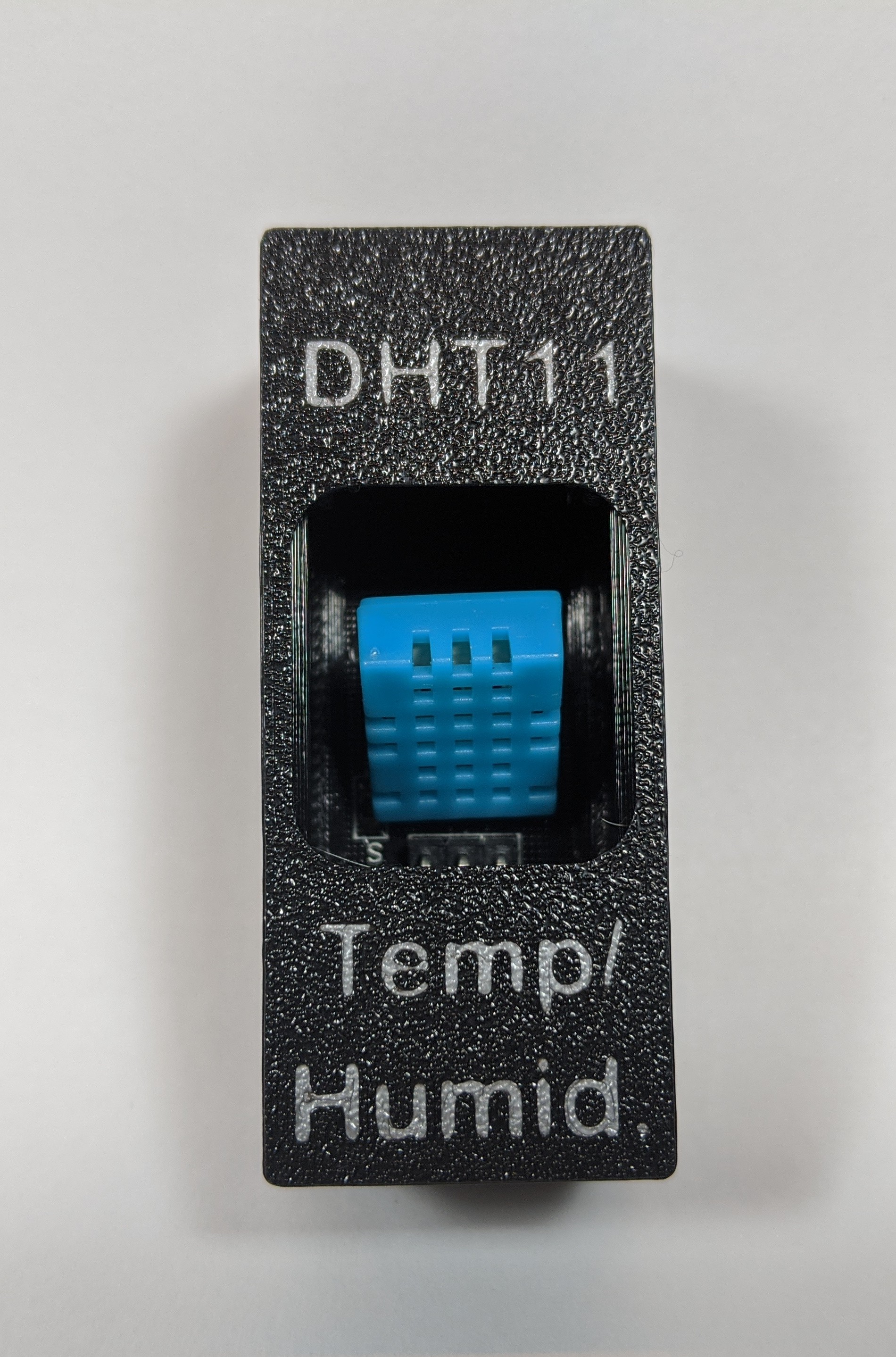

What is the Active Heating Circuit that you are talking about?

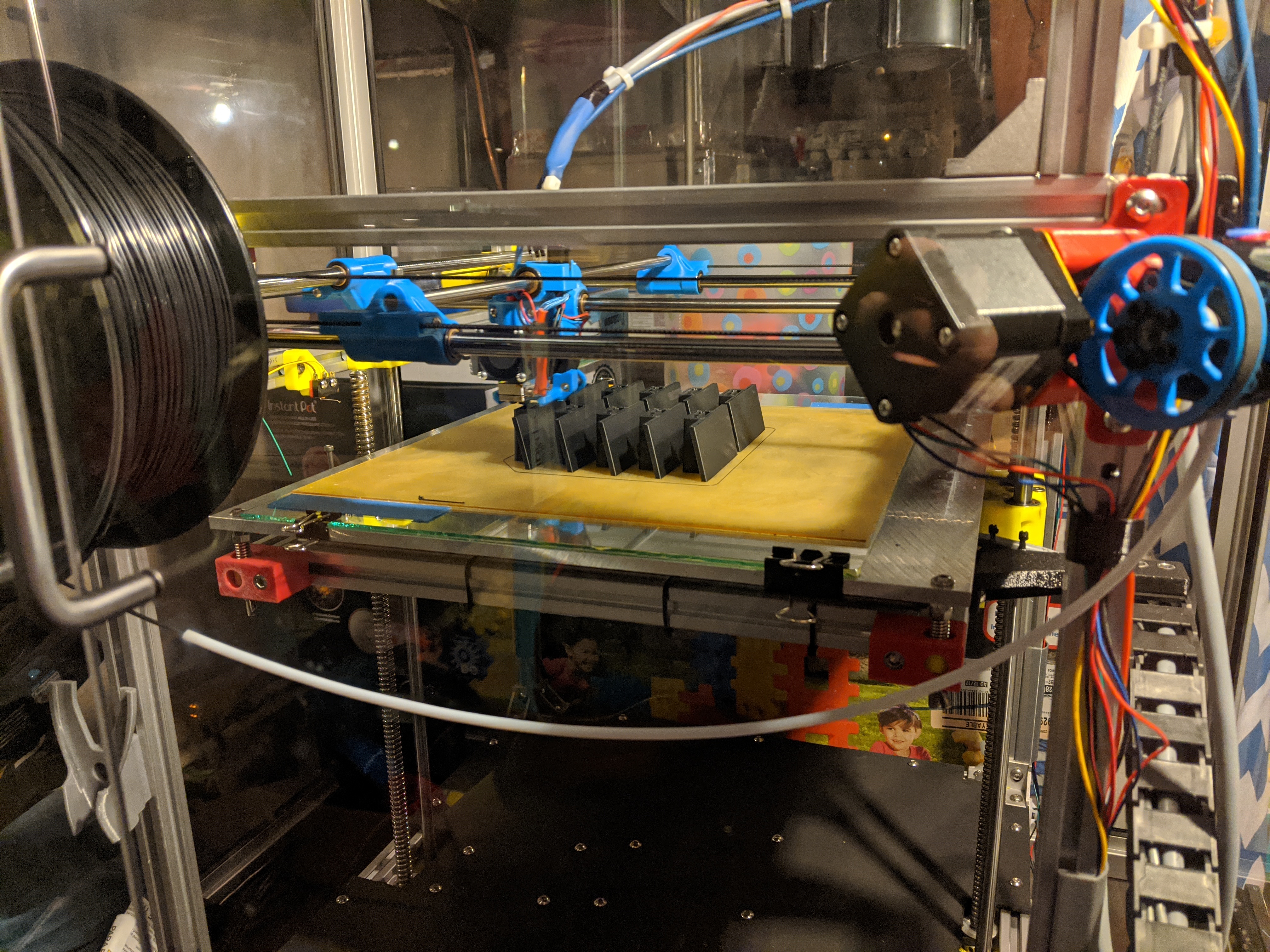

I saw in one of your pictures a tablet with controls? What are you using and what is the software?
I also noticed you extruder and is was belt driven what is the design?

The active heater circuit is an option in Octoprint, which is being run on a raspberry pi. I am using the enclosure plugin which allows for addition of inputs and outputs. In this particular case I have a DHT11 temp/humd sensor as my input, and an electrical outlet with a small 200watt heater connected. I have an enclosure that will heat to a predefined temperature, this is useful for controlling warping and cracking of ABS parts.
I am also running there premium version of Printoid on a crappy little jail broken tablet that I had. It’s a nice little visual interface of Octoprint that allows for custom button commands etc.
The extruder is a Mobius 3.1, honestly it is without a doubt the best extruder I have ever used, you can find the files and BOM at www.vorondesign.com
I tried Github. I consider myself reasonably skilled with computers. It makes me feel stupid. Here is the link to the files: https://github.com/Breeder18/EustathiosSpiderV2
Eric please put them in the community mods repository. I still have to add additional files, including the mods for the cable chain, the belt shield for the Z drive, and the modified electrical connection. I added a few versions of the carriage, since I had trouble with mounting the BLtouch. I think the best option is deeper holes that are tapped. I made them deeper and tapered to hole the screws better. The original holes were much too small for a heat set insert.
