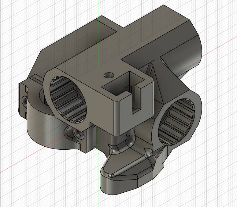

As far as design of the compact carriage, I would make the holes deeper for the press fits and allow for expansion of melted plastic/pass through of screws. The top of the BL touch mount should be angled slightly. When trying to install the microfit connector there is next to no room, and as a consequence the wires get bent pretty severely going into the connector mount
On a complete side-note I am not a huge fan of the Acetone press fit technique and wish this was more of an epoxy connection. y prints always split just a little bit when the bushings are pressed in, no matter how much I ABS soften the surface. Additionally I understand that ABS decreases the strength of ABS plastic.
I know what you mean about the tight wire routing. It’s doable… but requires adding some serous bend into the wires. I thought about spreading things out… but figured compact carriages main point was to increase printable area, so I left it really compact.
What area do you think sloping could help? I can get that added to the model. If I roll over this edge, and open up the pocket underneath… would that help?
All my heat inserts were M3. There are so many varieties of those inserts (different ID/OD/Depths). I should probably call out the ones I use with some notes. But I think I can increase the space below the inserts for thermal squeeze out during insetting. That being said my inserts are tapered m3 heatset… so I had almost no squeeze out during install.
For the bushings, I could make a version with larger bushing holes or some glue channels for epoxy-in methods. Just need to be careful not to get the glue in the self aligning portion of the bushing. Plus if the part is to dimension… it should have room for some glue as designed (See Picture)

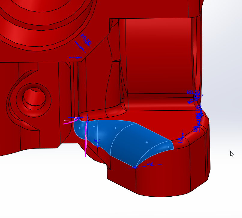

I added a chamfer, see above image. It might be too much as it appears to be close to interfering with press-fit holes. Ideally the chamber should only go on the outside edge to facilitate the molex sliding in at an angle.

See below for renderings of my changes:
  1. Enlarge bushing connections marginally and adding ribs to provide method for adding epoxy.
  2. Add tapered 3 mm hole for 3 mm filament to assist wiring support on carriage
  3. Tapered area above BLtouch, to allow for easier installation of molex connector.

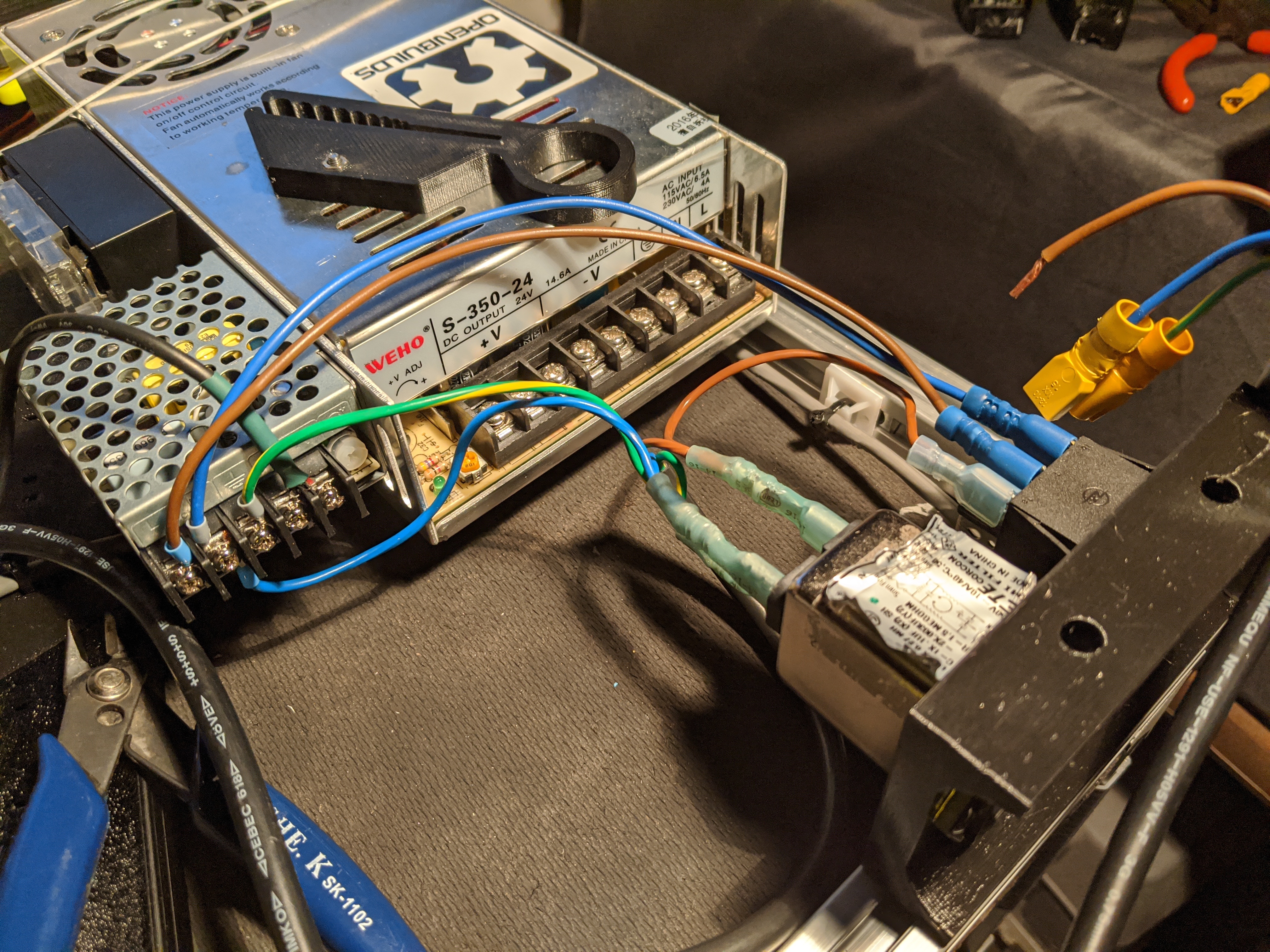

I’ve been inspired by some of the excellent build and designs on the Voron Discord, and the fact the my wiring has been completely ganky for years now I don’t want my toddler reaching into my printer and grabbing mains power. I would build a voron but can’t justify spending another ~$1500 when I have a very capable printer that just needs some tlc. I have been rocking their Mobius 3.1 extruder, which is an absolute tank, highly recommend. I have been very happy with the printer thus far.
Total modifications include:
  • DIN rail for Mains (120V) and 24V
  • Dedicated 5V meanwell PS for Rasp Pi
  • Filtered Mains inlet (the one in the Eustathios BOM melted on me and scared the hell out of me), I altered the Voron design slightly to allow for a different switch along with their recommended filtered mains outlet.
  • Thermal cut-off fuse mounted to heatbed in the event of SSR failure
  • Secure wiring and support on carriage using molex with shielded 8 wires (from Eric), making for a cleaner more robust setup. New 3d printed mount on 2020 frame to secure carriage wiring. Added BLtouch using new carriage, just need to figure out how to set it up with Azteeg
  • New 3d printed X Y gantry mounts from Eric, much slicker looking, and appear to be lower weight.
  • 3d printed belt covers to allow for safe wiring without risk of belt touching wires, and provides ample area for securing of wires
  • Complete rewiring of end stops to reduce messy/loose wires using shielded wires
    Install plate on the base of the printer to mount electronics
  • Newly designed cable chain brackets that provide safe cable routing for heat bed to electronics area beneath printer.
  • 2 switch setup, one for 5V PS the other for 24V PS, in process of figuring out how to wire in relay for use with powering printer 24V on/off through octoprint. COVID-19 has really slowed down a few orders from Ali that I placed about a month ago for the 3.3V relays.

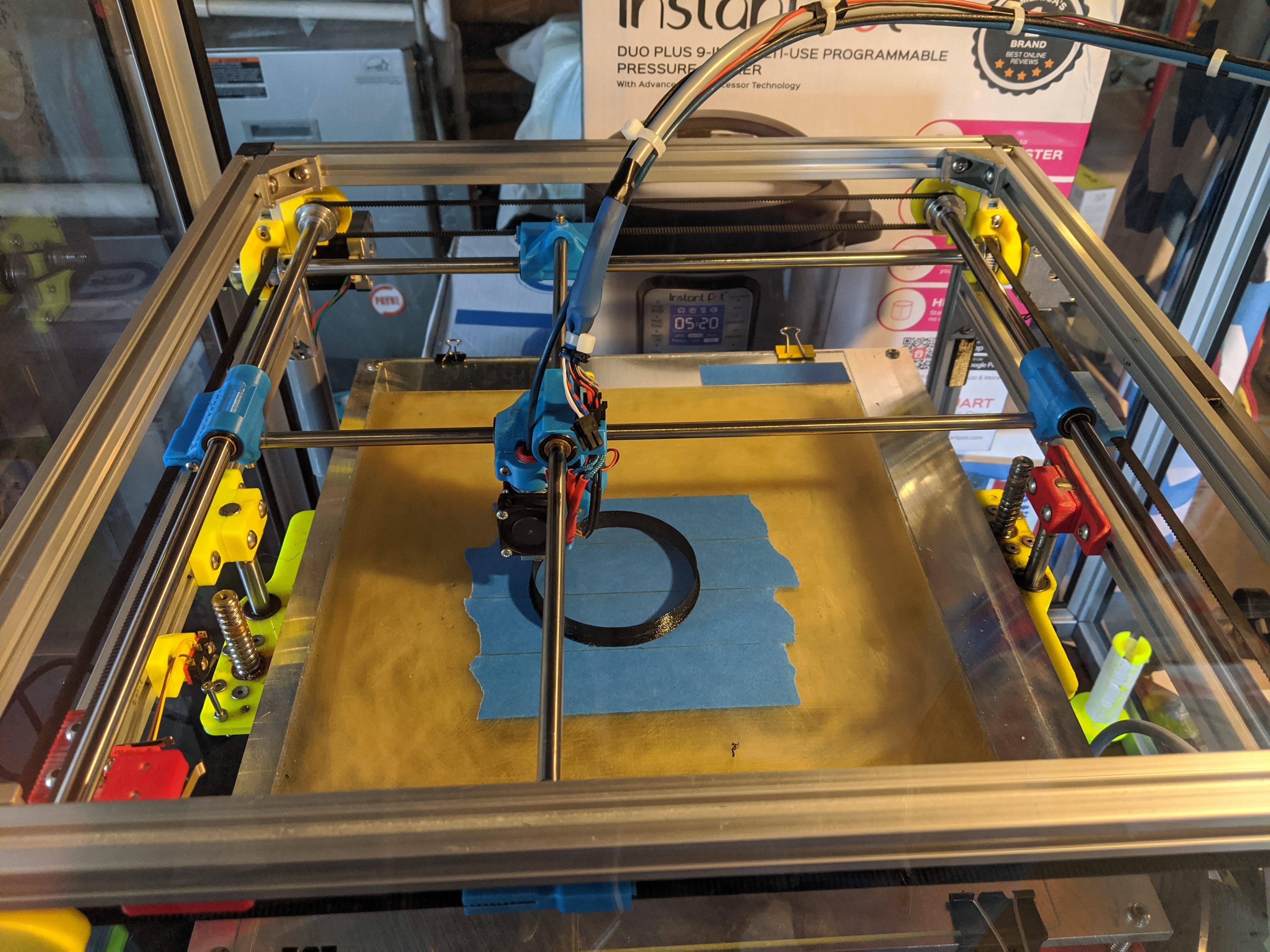

Hey Sean,
Might be because I’m at work and a lot of photo sites are blocked, but I’d love to see some pictures of your setup. I too am trying to slowly clean up my Eustathios and make it “neater”. It unfortunately spent some time in a garage while I too was moving in to a new place so it also needs some TLC. Would really enjoy seeing some setup pics to inspire me to organize my rats nest of a printer setup.
Thanks for your work on this carriage, it looks really nice. Would there be anything preventing me from using PETG with this design? I too don’t have an enclosure and can’t print ABS very well. I also really don’t dig the fume smell from it and really only print in PLA and PETG these days.

I have included a partially completed wiring diagram, that has been tested as of this morning to power the system on using octoprint and the GPIO raspberry pi outputs. I have 2 switches on mains, one is 5V and the other is 120V that goes to relay (need switch on in order for automatic activation to function).
I was able to reprint the carriage with modifications that I linked above, the changes worked perfectly. I was able to epoxy the bushings, and now my perpendicularity is much better. I can actually move the carriage by hand now, before there was ~ 1mm misalignment from one end of the rail to the other. I have included images of the originally printed carriage and will add more as it comes together.
Ryan, I forgot to reply to your question about PETG parts. I would highly adviser again PETG for printer parts, it’s too “gummy” and it’s more likely to creep under load.
