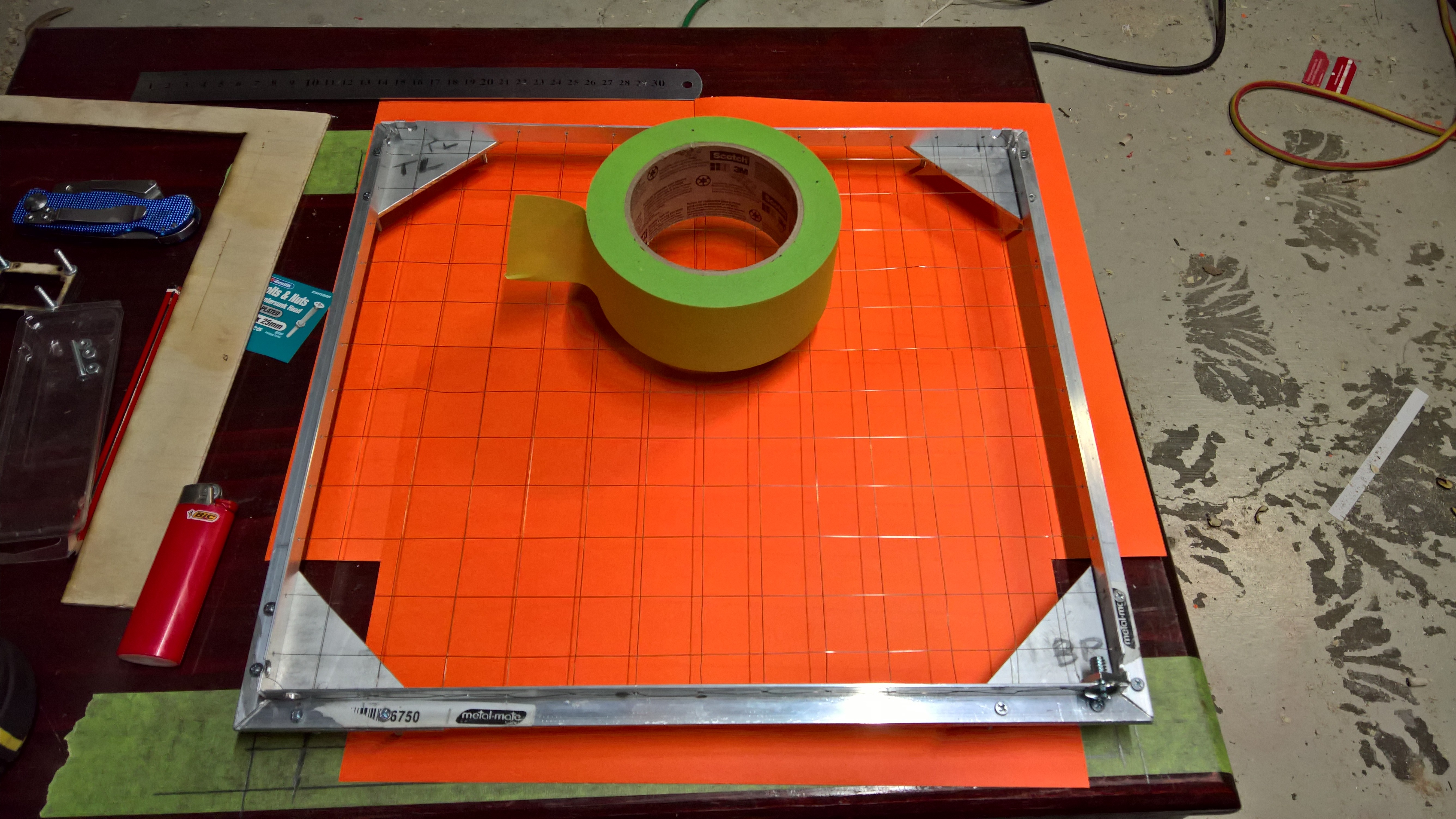

New cutting bed that I just finished creating.
New cutting bed that I just finished creating. I used 27lb fishing leader wire to create a woven mesh with minimal surface area that will support the piece to be cut. It could do with something to tension it tighter (can’t really think of much to use other than turnbuckles or guitar string tensioners, any suggestions welcome).
Overall size is 355mm x 330mm (to the outside of the 12 x 12 aluminium angle frame).
Cost was about $3.50 per 1m length of aluminium angle (x2) & $5 for the fishing leader wire. I already had the aluminium plate laying around at home, so not sure what it would cost for something like that. I guess you could use whatever you have laying around for that purpose.

That’s a nice idea, really minimizes the risk of getting burn marks on fx acrylic and glossy stuff. Tension will be important for sure. but weight from the material will also be at a minimal.
Thanks @Susan_Moroney .
@Ariel_Yahni_UniKpty I’ve still got to work out how I am going to set it’s height. I am considering while I am at it, to make a manual Z-bed with this, as I could use the 4 triangular aluminium plates to have bolts go through.
@Gunnar_Stefansson I think the nail/needle beds might be the best way to minimise the possibility of burn marks, but depends on how much support you need.
