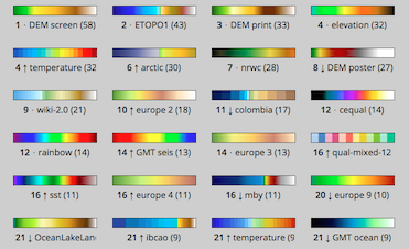

There’s a great web site for color designers called “cpt-city” (short for ‘color palette city’) that has page after page of pre-designed color palettes, for all kinds of things from art to science, maps to video games. Check it out: cpt-city
Ever since FastLED gained the ability to use color palettes, I’ve been wondering how to make the whole cpt-city color palette library available to FastLED animators. Well, today we’re releasing the first version (read: it has limitations, bugs, etc) of a tool that lets you import cpt-city color palettes directly into your FastLED animations. It’s called PaletteKnife .

Basically, you browse to the color palette that you want, and click PaletteKnife (a bookmarklet) in your browser. Then you COPY the resulting code, and PASTE it into your FastLED animation source code. Palettes that you import from cpt-city will look like this in your code:
