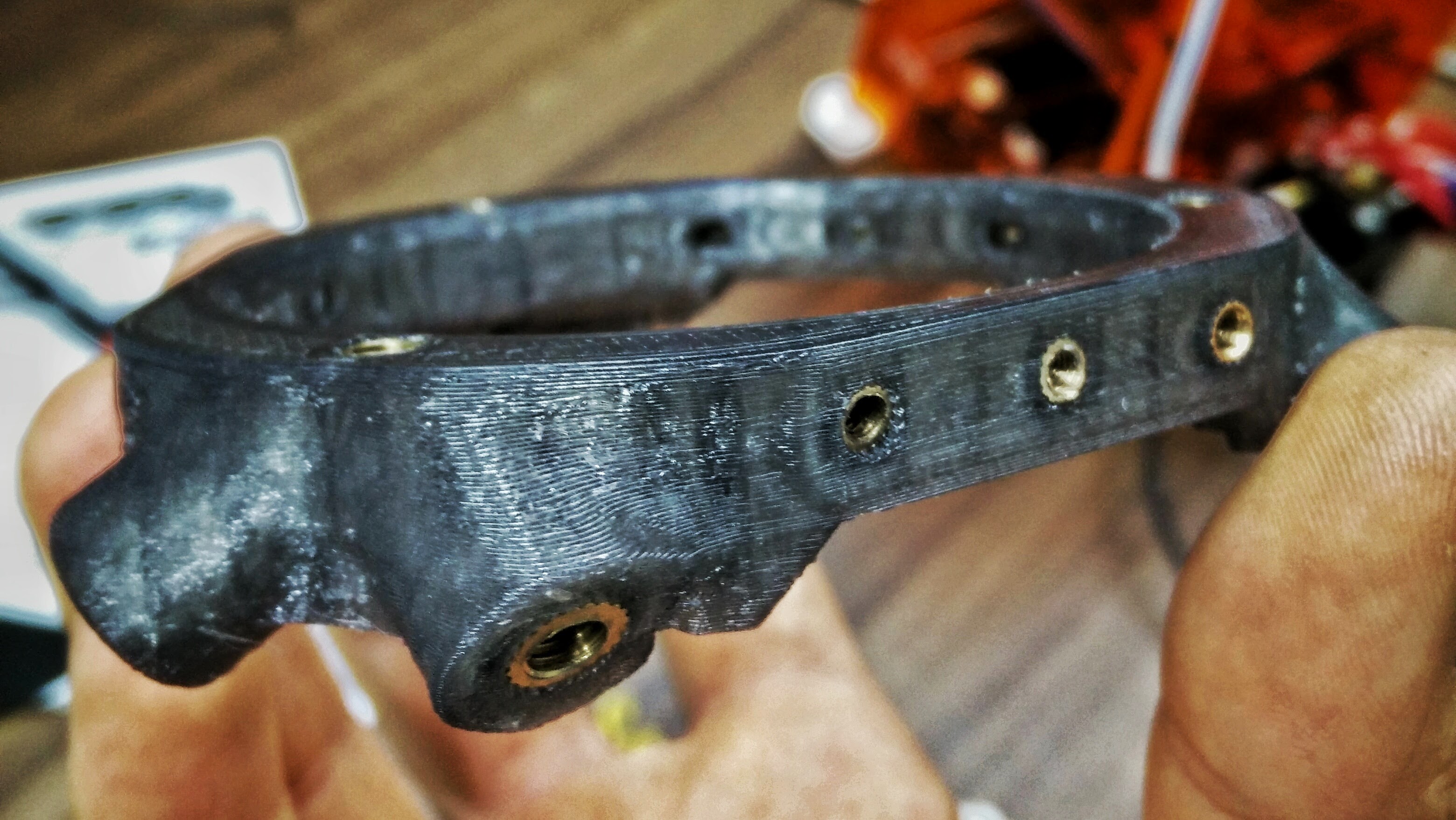

New effector for my CerbrisReborn Delta - now with 100% more brass inserts! Plus,
Plus, parts printed from E3D Edge simply look amazing - even more so with a little brass for contrast.

Is it printed without supports?
What did you create the model in?
@Mark_Fuller it was printed upside down compared to how I’m holding it here, so no supports needed.
That’s what I was thinking. I’m leaning towards a magnetic mount that ties into a ring like yours.
@Thomas_Sanladerer still using the same ball joints? I’m thinking about using IGUS Igubals but I am concerned about play. I know you mentioned you were considering switching. Any changes/recommendations?

@Griffin_Paquette yes, same metal ball ends. I simply want to see how far i can get with them before i take the plunge and go for Igus or a magnetic setup.
Should the brass inserts be on the opposing side if you want to have the part fighting against the pull effect of the screws?
@Jean-Francois_Talbot yes, ideally. But these aren’t particularly thick, so they wouldn’t end up with a whole lot of plastic to prop up against.
The inserts do have a slimmer section in the middle so that you get a bit of the same effect when pressed in from either side.
