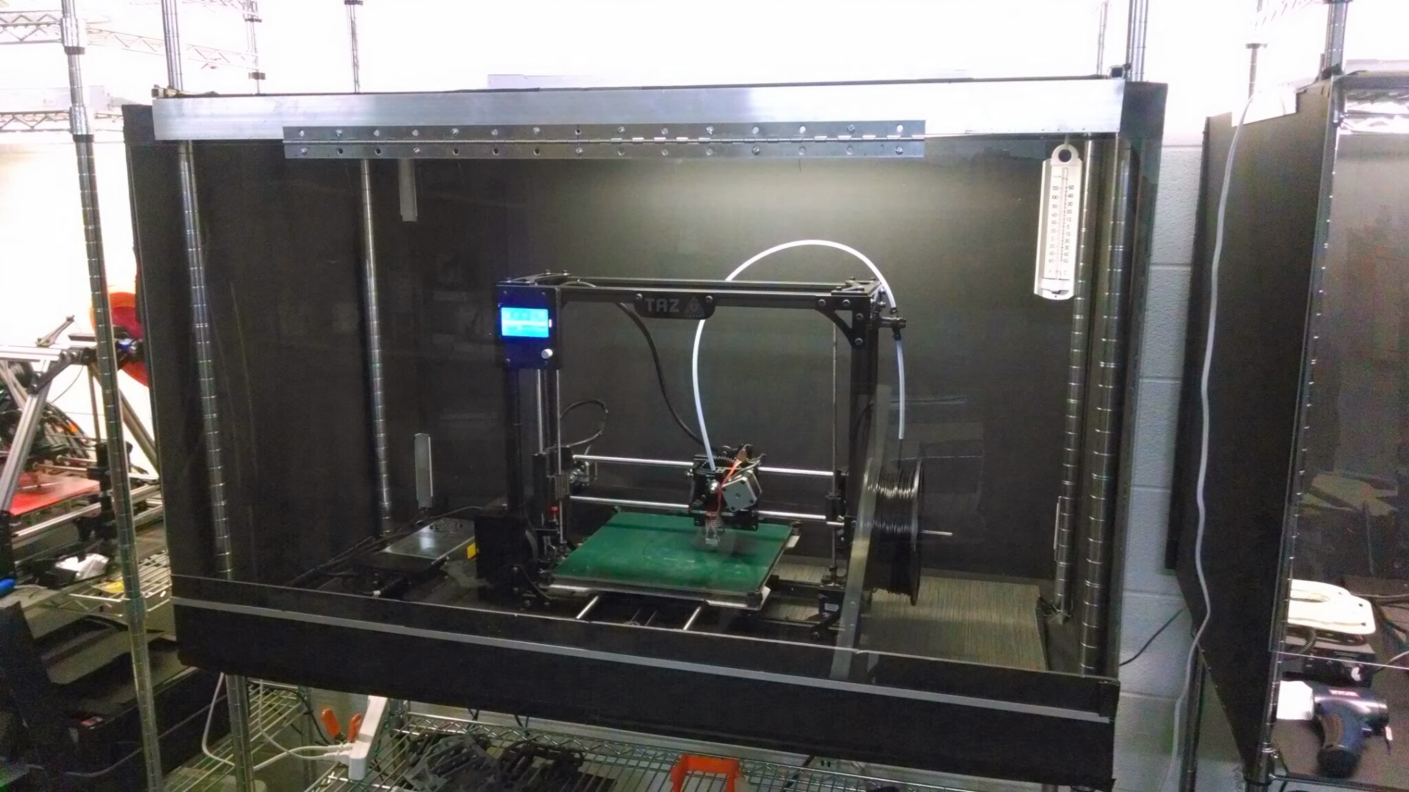

New enclosure for one of my TAZ2s.
New enclosure for one of my TAZ2s. Finishing the other tonight.
Black foam core, acrylic, some angle extrusions, double sided tape, gaffer tape, piano hinge.

@John_Pacyga it is eliminating my de-lamination issues. Ill upload a before-after photo. Printing with ABS.
@3dpod_3D_Printing_Se staying at a nice 23-25C at idle with bed at 105

here is a before (L) and after ®. Surprisingly hard to share a G+ photo in comment on G+. Lets see if this works.

It was easy to build the enclosure around shelving frame & I have room to rotate the printer around for access if maintenance is needed.
I have sealed it up pretty air tight. The black foam core boards act as insulation. Only major heat loss is when I open the plexiglas door.
