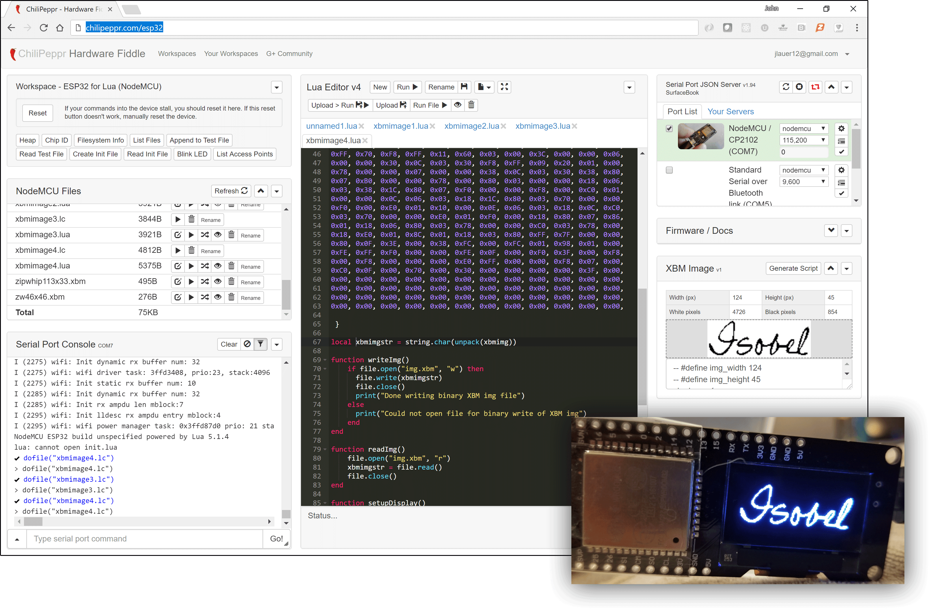

New ESP32 workspace launched. http://chilipeppr.com/esp32 I love the new ESP32 boards! Game changer. The workspace has an extra goodie for uploading XBM images to OLED displays as easy as cut/pasting into the widget as seen in the screenshot below.

Flashed your bin files with the esptool and brought it up in Chilippr, ran heap, chip id, filesystem, AP access… all worked except blink but I did not look at why. Using a Sparkfun esp32. Very cool to be back in this environment with the much nicer esp32. Thank you John.
Yeah, just pin 5 not pin 2 for this board’s blue led to blink. Works now. First image I tried to copy for XBM hung and after 3 waits I killed it. I have an OLED and BME280 running using the Arduino stuff and even made my own graphics using some conversion stuff from Adafruit instructions to convert to arrays you put in the code itself. Not sure what is an esp32 and what is esp8266 at this point. There is so much to this chip so I hope the LUA stuff keeps up. I’d like to be able to get the Bluetooth config of the AP working so a cell phone can be used to configure the WiFi. Without that it’s not going to work for something like my remote guitar case humidity monitor.
When you say hangs, do you mean the uploading/running of the script to the ESP32? Or do you mean the importing of the image when you hit paste?
Paste…
Which browser are you using? Do you at least see the initial image show up, but just not the monochrome one? Is there an error in the Javascript console at some point? It’s a new feature so curious the bugs.
Chrome, no image, did not check console. I will do more later when I have more time. Sample OLED project would help.
