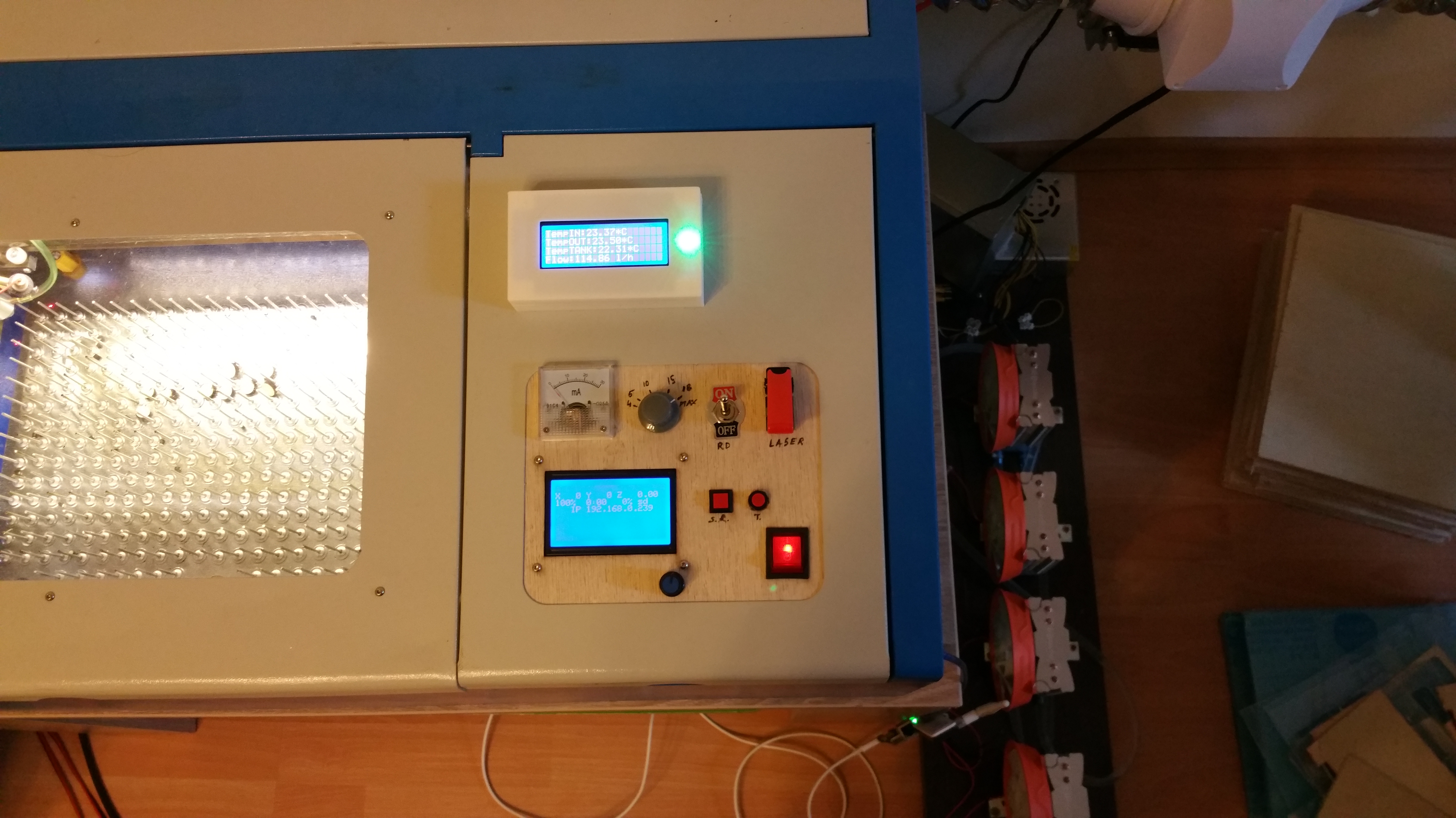

New front panel to accomedate the GLCD.
Love the rocket launch Laser Switch :slight_smile:
Mircea,
What are you using to produce the temps? I am thinking of implementing the same thing as I keep forgetting to turn things on when starting a cut.
And what is that next to your K40? looks interesting!
To read the temps I use an arduino and ds18b20 sensors. https://github.com/executivul/LaserSafety To the right are the fan, the air-assist compressor and the chiller.

I use a nano and keep the safety system independent of the controller.
You can check the github. I’ve updated the code to the latest.
