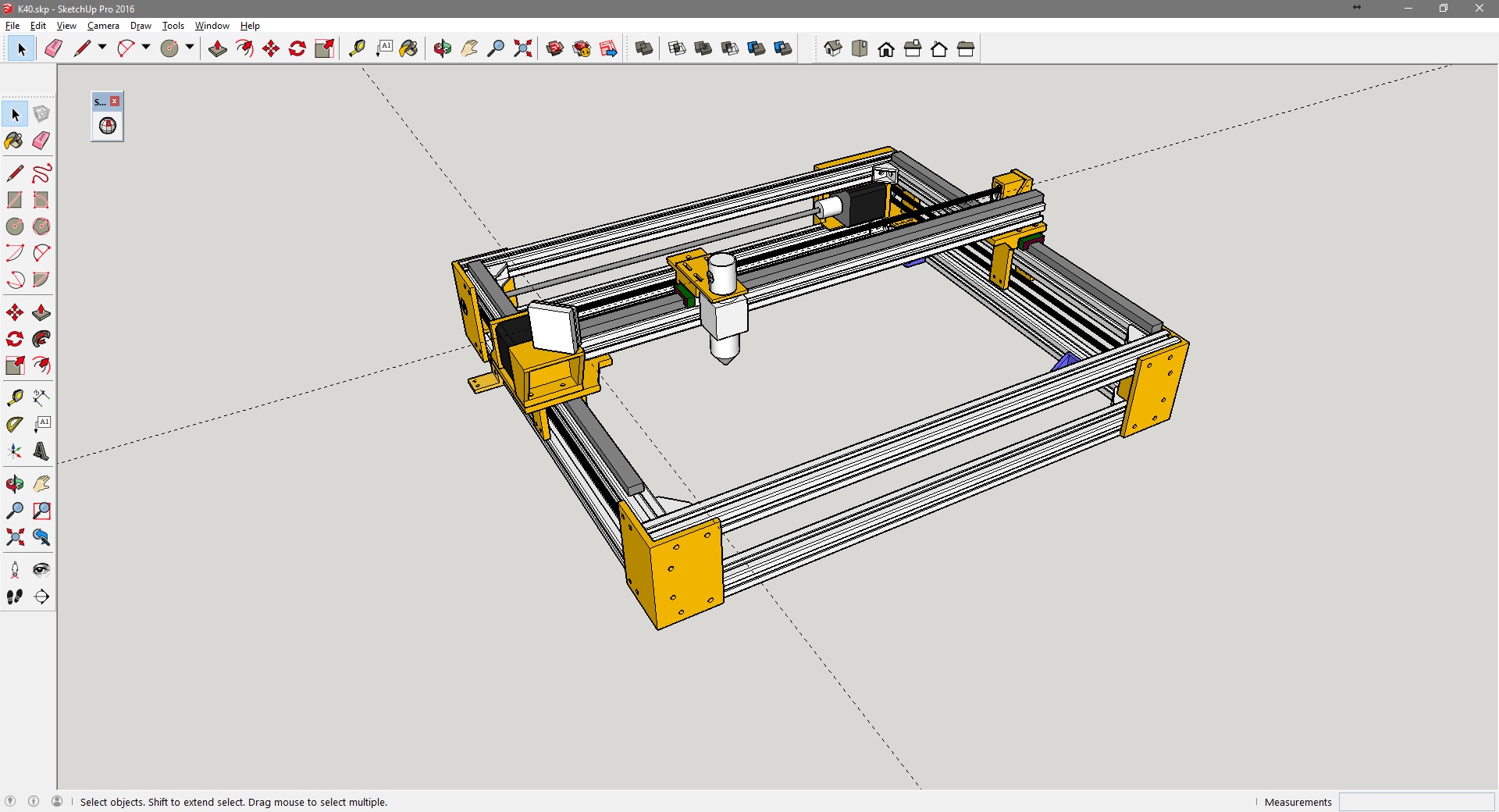

New gantry is almost complete. I'm still waiting for the longer x rail.
New gantry is almost complete. I’m still waiting for the longer x rail.
Should get a few more cm out of it at 40-45cm/27-28cm, not quite 30/50 but close enough for such a small envelope and half the price of the G350. I still intend to keep all the electronics inside the bluebox and just move the separator wall to the right by a few cm.
New 12V steppers, should take the load off the poor LPS. Take note the latest edge smoothieware has some issues with homing, it hangs the board. Using latest master branch and new config style all works great. Hope to see it inside the box soon.

Looks good. Where did you get the rail?

Did you by any chance share the model on the warehouse.?
https://www.aliexpress.com/store/group/MGN-MGW-series/1452393_259128619.html?spm=2114.12010608.0.0.8bcPd0
This are the rails, they are buttery smooth after some good greasing. Still waiting for the longer X one.

@donkjr I shall publish the files after I get it working, on the table the moves are perfect, but only laser can tell if I get missed steps and only time will tell if my PLA parts start to crack. I used PLA for more rigidity, using ABS required twice as much material and a heated chamber for the printer.
@Mircea_Russu did you know that you can upload A SU file to the warehouse and share then just keep it refreshed as you make changes. That way we can track your progress? :slight_smile:
@donkjr just search the warehouse for “k40 laser gantry” you should see it.
@Mircea_Russu ok, BTW you can search for K40 and see my optical layout and other K40 stuff.
