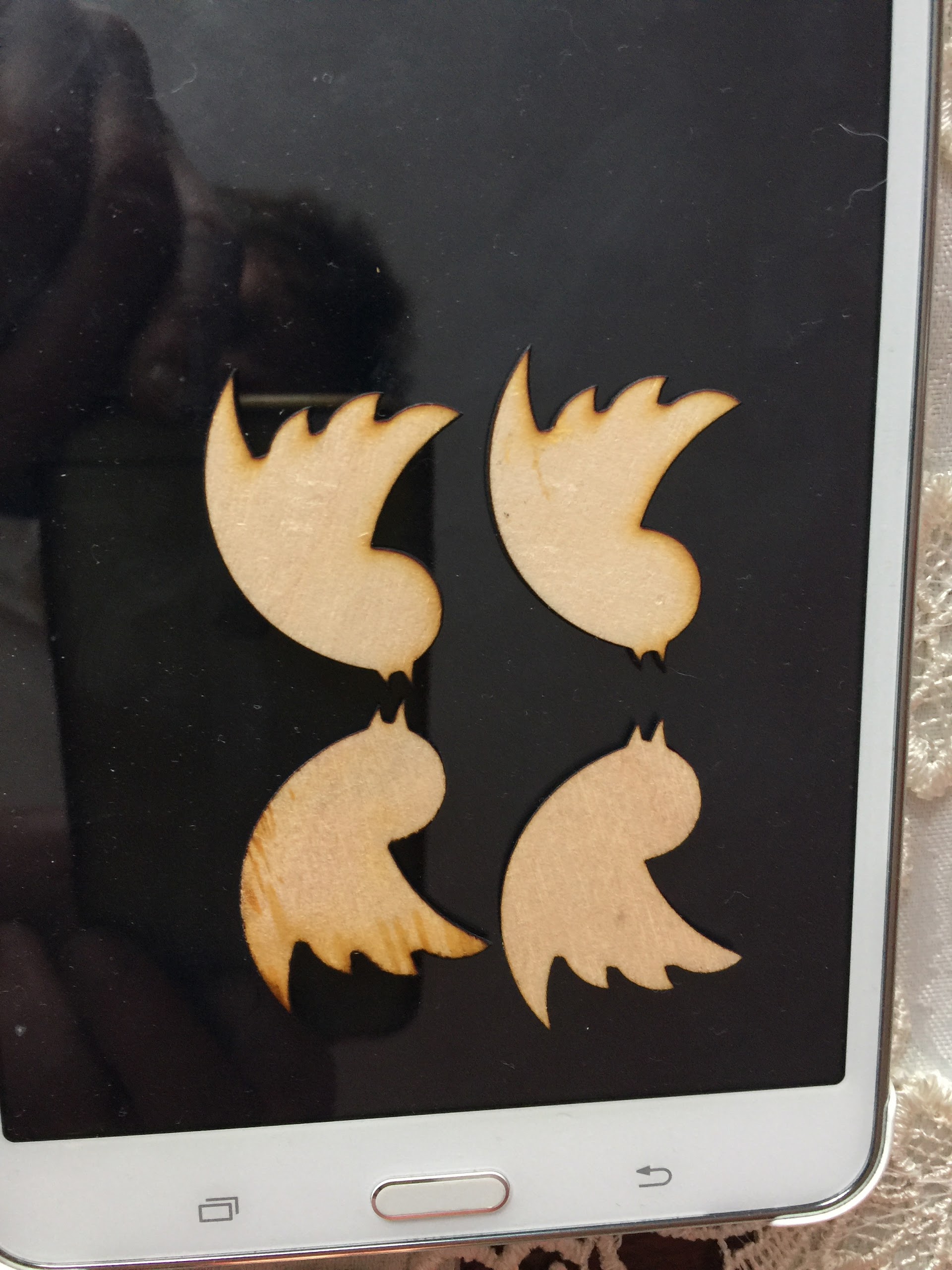

Today im cutting some slats for bed(same type like in Trumpf machines,but in micro scale)
Lots of fume marks on cut items lower left looks good -is this one showing the rear of the cut,with my setup the rear of the cut is noramly cleaner than the top,if you can try increasing air pressure-i am running full size air compressor amd using 10 psi.l to found that the 18mm focal lens heaps better than stock lens size.C an you post some photos of the work peace still in the surounding material ,top and bottom
This diry side is bottom,i was cutting on solid plate
i was using a solid plate for awhile then switched to 10mm wide by 15mm long magnets with 50mm long screws held on top ,this way i can use it as a pin bed as well as move them around ,was going to make 1 dozen magnets/ screw combos however only needed 4 so far- this will help lots with the fume marks and the cut parts just drop down clean
i was thinking about a honeycomb bed then thought i would be forever cleaning it
