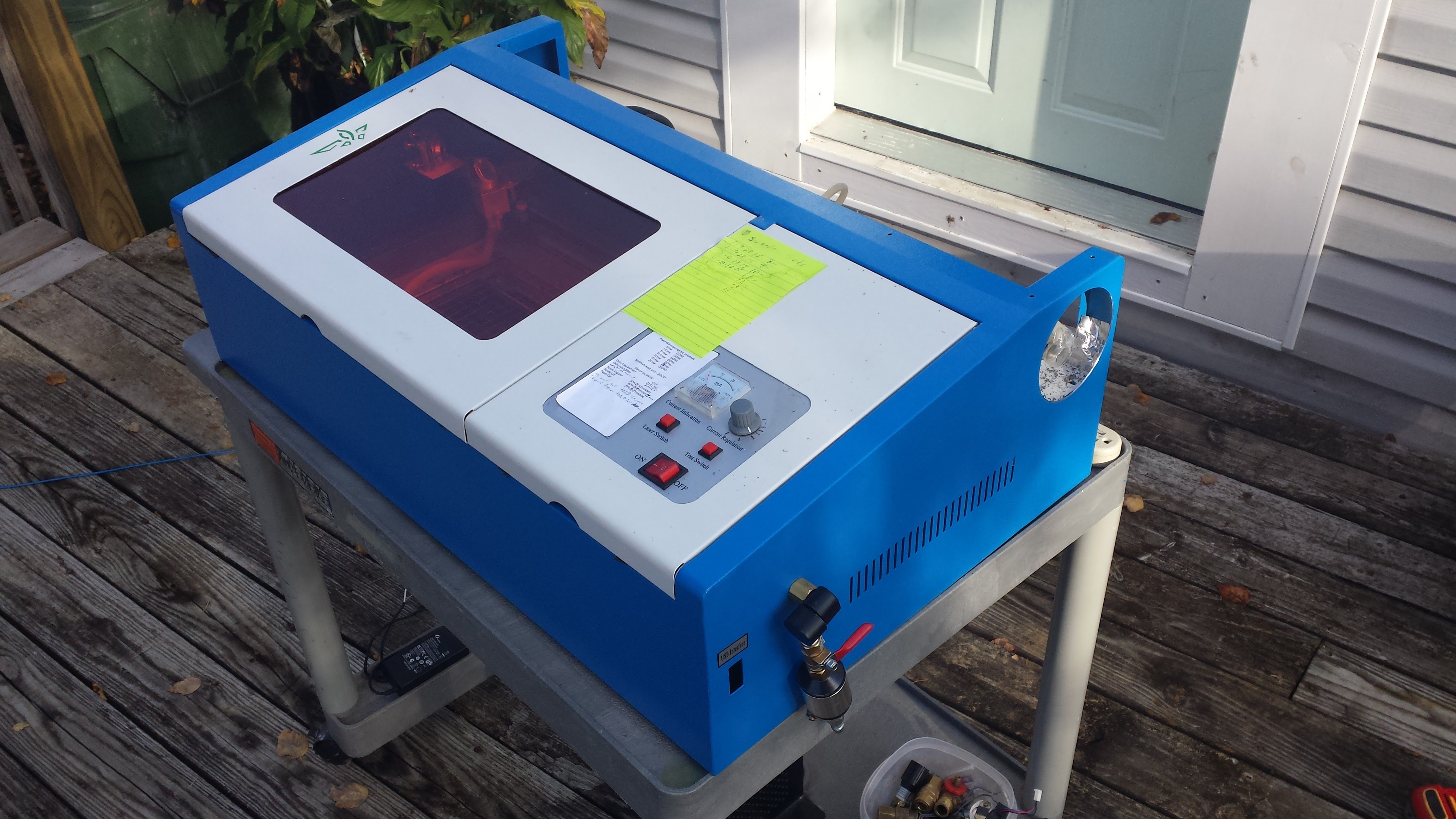

Had a need (I thought) arise to replace my tube, and the supplier I bought from in Las Vegas had his 50w tubes on sale for the same price as his 40w, so I did what any good old tinkerer would do.
I cut a hole in my cabinet, and bolted that sucker in.
I’ve since learned that it may have not been my tube, but a wiring issue that I later resolved, so now I keep my 40w for a backup spare, or a later project.
Not a well lit picture, but I have an LCD mounted on my cabinet with a mini PC mounted on the back dedicated for laser operations.
Used a 4" diameter duct for shielding on the extension, and sheet metal screws to attach it and maintain ground. The end cap pops off in case I need to get to the water tube or electrical fittings easily.

LightObject has an extension box to do the same thing so you can fit a 45W tube (1000mm vs the stock 700mm). It’s square in shape and made of the same light gauge steel the K40 cabinet is made of.
I like the ingenuity of the duct but would worry something in my garage would end up bumping it, leaning against it or jumping on it and there’d be magic gas leaking everywhere :slight_smile:

It’s surprisingly rigid, and I have planned to add struts if needed, but where it’s currently installed there is no chance of bumping it.
I almost got the one from LightObject, but again I needed to be up and running as quickly as possible.
