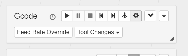

Go to the cog wheel “settings” icon in Gcode widget.
Then you’ll see this dialog.
Try changing number of lines to send at once to a higher number like 150 from the default of 50.
