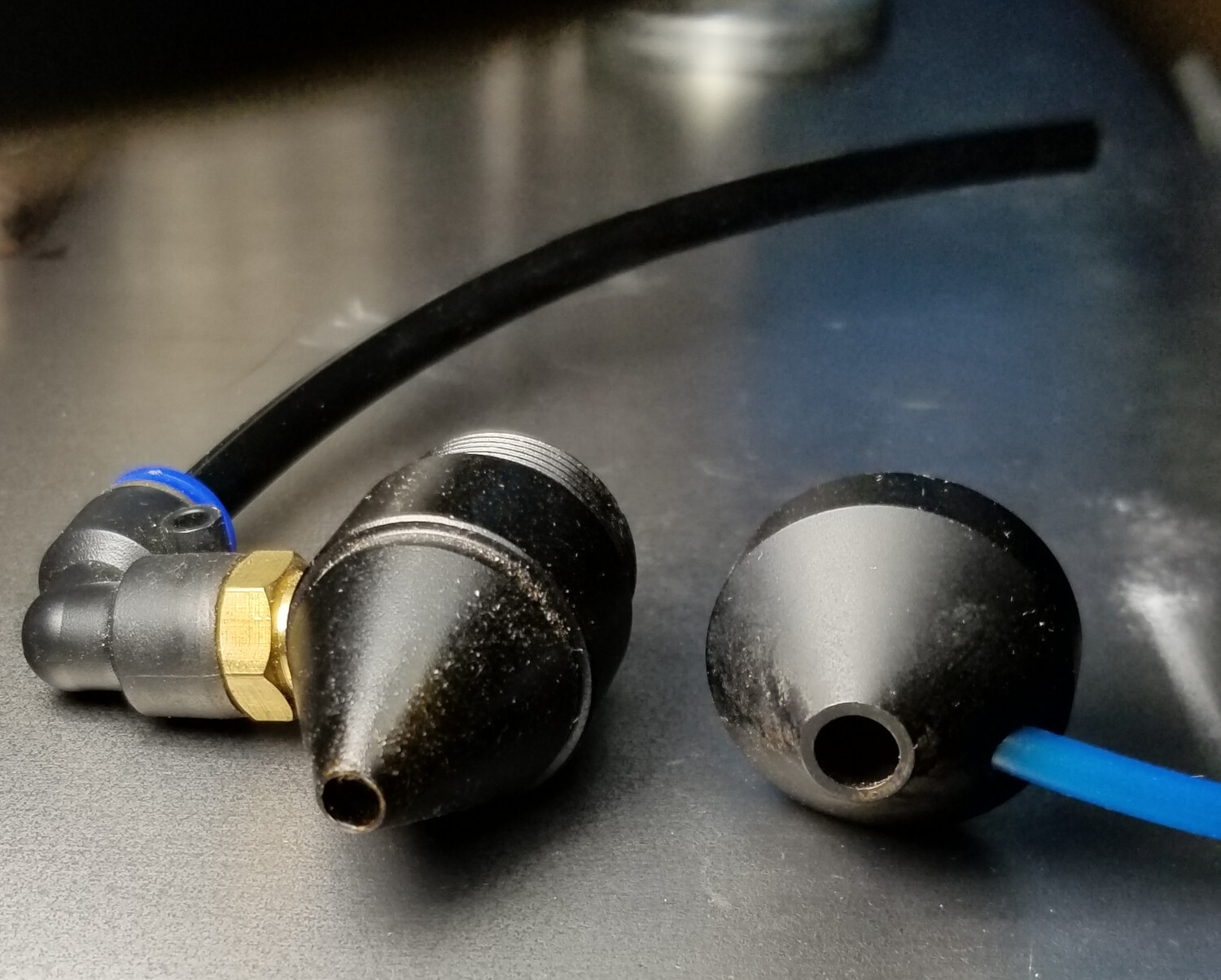

The worst part about those is how far away from your focus/cut the cone output is. The Coudray tube system is far better but it does require something like a Russ Sadler K40 head mount setup.

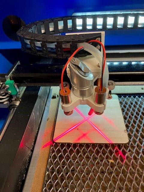

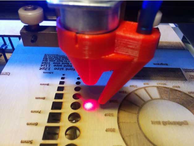

I did get one of these as I assumed it would be better that the stock head but in reality it still took the same number of passes to cut so I sent it back. I had read somewhere that a cone can actually cause smoke to swirl around inside the cone and it was better to use a side air assist nozzle which I printed myself and simply pushes onto the stock head. It simply blows the ash and smoke away from the groove. My air assist is particularly strong and I do wonder if there are circumstances where it it ought to be held back. The nozzle also includes the housings for the red dot lasers which I find extremely helpful in knowing where the cut line is and having two perpendicular mounted means that they are always correct irrespective of height. Luckily I have a manually raised bed so changing for differing material thicknesses is also very simple.

To be fair I can’t remember where I saw this. I think it is to do with the air coming in at the bottom of the cone can cause eddies at the top under the lens but it seems to me that blowing from the side with the lens in the open is a more logical way to remove debris from the groove and I find this does seem to work for me particularly when cutting.

Until I saw Russ Sadler’s air assist nozzle which can be adjusted vertically, I didn’t get why people were using the cones. The hole had to be rather large and it was so far from the cut it did little but to blow smoke away and needing a larger air pump. The tube design allows for the tube outlet to be closer to the cut and they can be very small holes so high pressure streams of air can blow lots of debris away. But the cone keeps smoke off the lens, so I created this design because it leaks air into the cone to keep smoke out AND it get a very small hole and fast stream of air close to the cut.

Yes I agree and my initial preoccupation is to use the machine for cutting which I could not really do with a diode laser so I did want that focussed air stream. I did see a post whereby someone had used the Pro head but then placed masking tape over it and pricked a hole in to reduce the hole size. I took a look at your design on thingiverse and mine is also from thingiverse is clearly a remix of your design to include the red dots but without the cone so I will consider this design in the future. In practice because I have a short tube to extract smoke to the outside and I fitted two fans pulling air in from the front and across the bed, I am not having any smoke problems inside the cabinet and indeed checking both the mirror and lens I have not not seen any deposits.

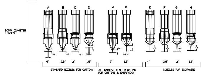

The C series lens tube and nozzle are very configurable. Depending on what you are doing.
They can be flipped to handle different focus length lenses.
C-Series-Lens-Tube-2_500x500
Configured for different operations.

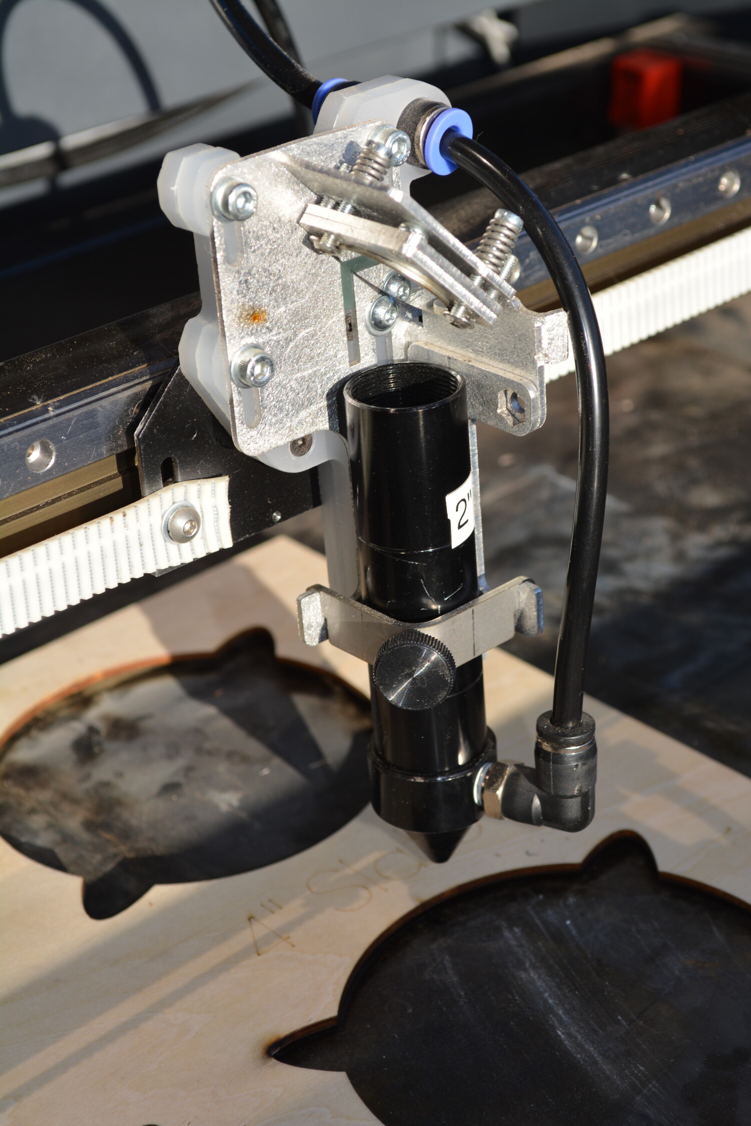

This is my head assembly… no led pointer or drag chain… lowers the mass immensely, allowing higher acceleration values and of course speed great than you could really use.
