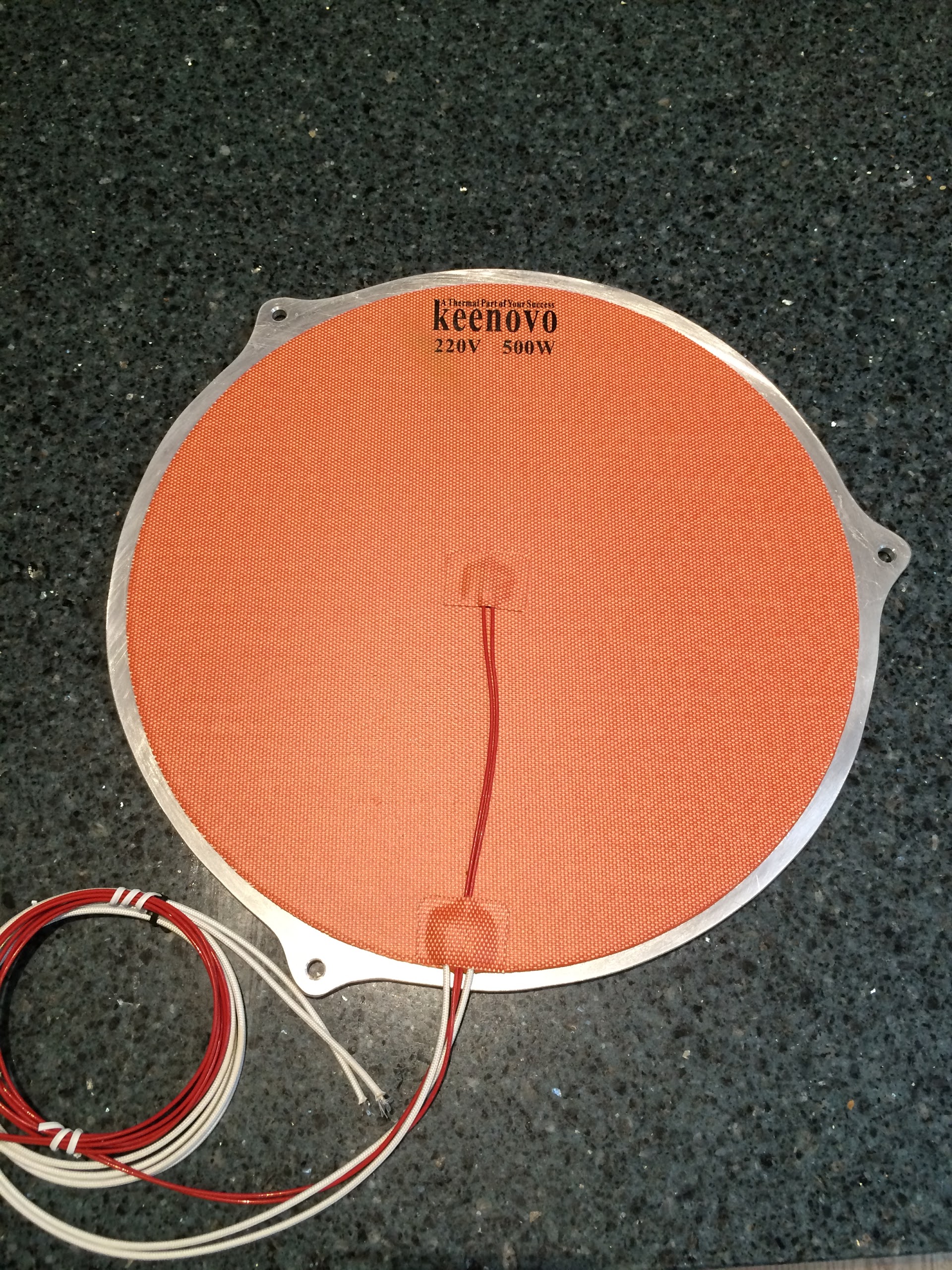

New Keenovo 300mm diameter 500w 220v element for my Delta Printer bed.
New Keenovo 300mm diameter 500w 220v element for my Delta Printer bed. 4min 30sec to reach 110ºC with no insulation. No more waiting for the bed to heat up #keenovo #deltaprinter #3dprinting

I can’t see what the end of the red wires look like but I’ve always had them terminate it in a 2 pin dupont connector for plugging into RAMPS/ other control board directly.
@Ivan_Hoe You can also email them directly, Johnny helped me out with power specs, made a custom shape per my drawing… In short they’ll do just about everything.
The red wires are from the NTC 100K thermistor and are just bare.

@Brad_Smith - yeah that’s how they come stock. Was suggesting they can put a female connector on the end if that helps in the future.
