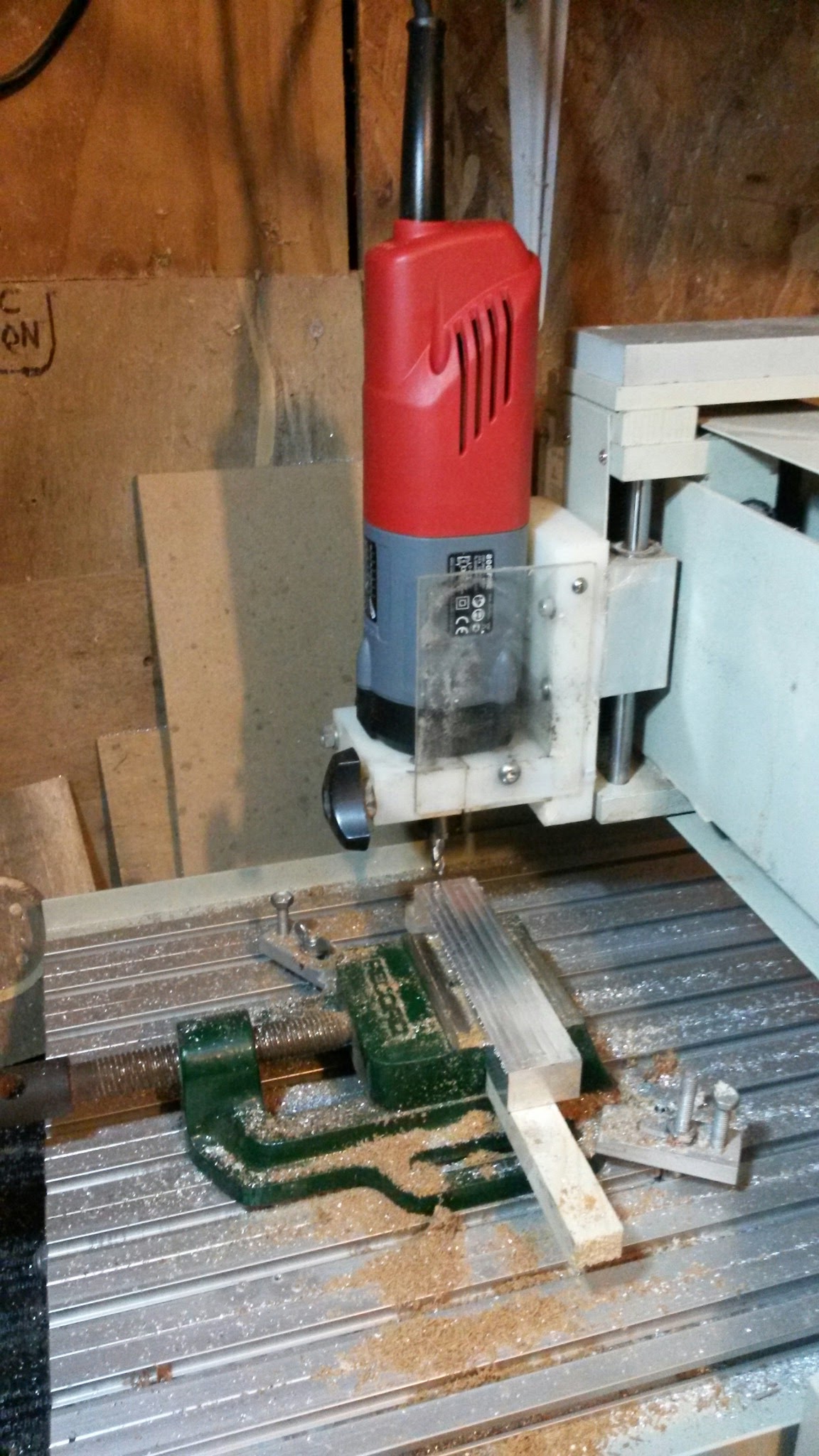

New Kress spindle, around 75db at 10,000rpm no load. So far so good.
New Kress spindle, around 75db at 10,000rpm no load. So far so good. Needs more set up, not running square to the bed.

@Eric_Edwards lots of small cuts is what I used to do with the old one, you just have to be patient. The cutters are fine, it’s the amount of flex in my mounting that is my biggest problem, when I get time, I’ll machine something stiffer, then watch the Y-axis flex, ha ha

@Henrik_Larsen I built my spindle mount for woodwork, in materials I had to hand (22mm thick nylon6) I’ll make the new mount in 16mm aluminium and brace it properly. I suspect at the moment my 12mm guide rods on the z-axis will be the next weak link.
