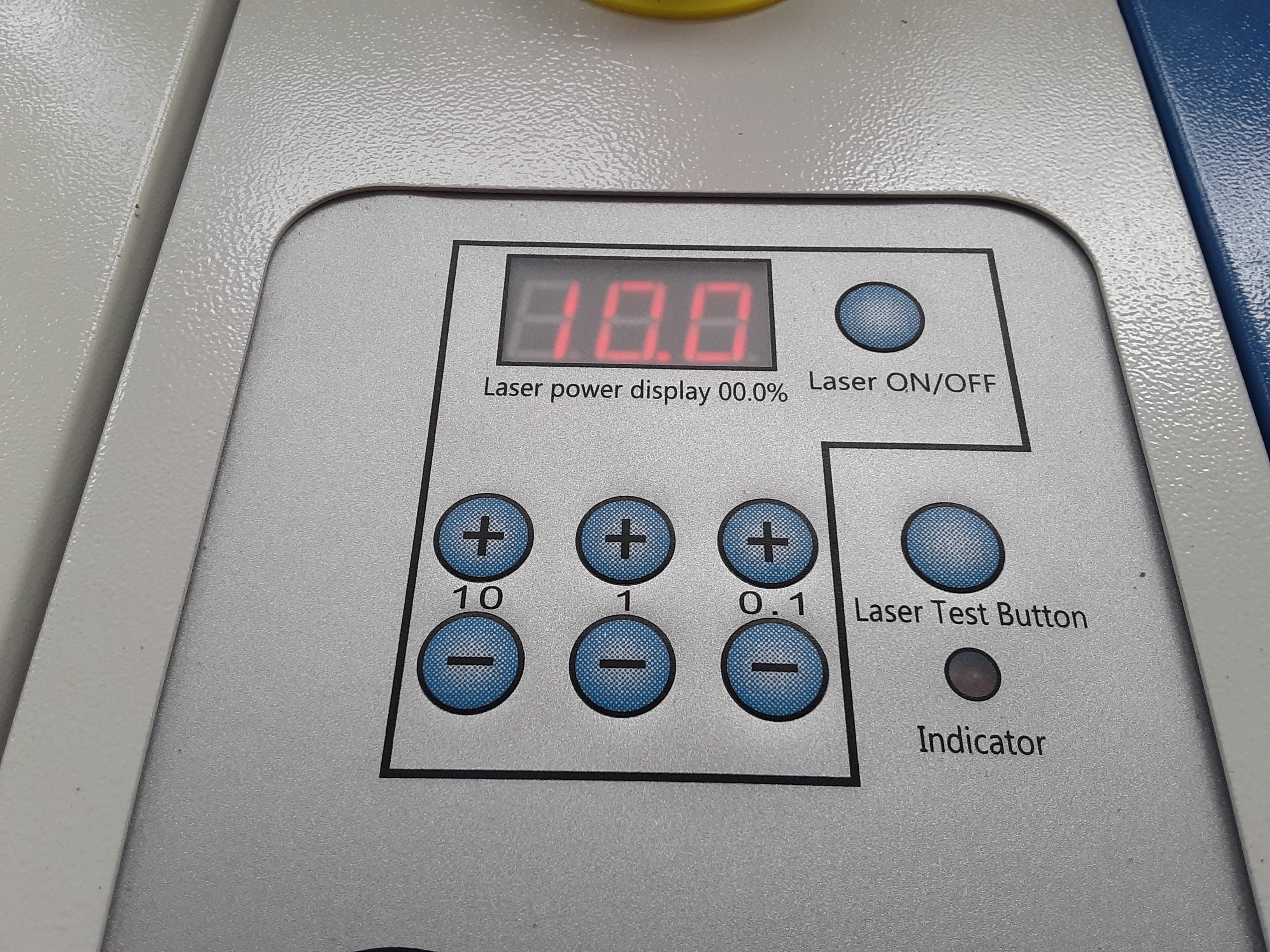

So I’m working with another machine from a different supplier than the last new one that came with the power supply not mounted and I have run into a very odd problem. When getting everything set up, I was able to get it to fire the laser from the test button the first few tries (after finding that there’s a water flow sensor that was keeping it from firing initially because the flow was too low). Now, what I’m dealing with now is that the laser will not fire from the control board on the door (with the readout and external controls), but it will test fire from the switch on the power supply. This has lead to an inability to run via the K40 whisperer software properly. It goes through all the motions, but the laser doesn’t fire when running a job. I see the indicator light on the front panel running the job just fine, but the laser isn’t firing during the job at all. Anyone have any insight on what this could mean?

Just for verification have you tried toggling the laser on/off button? this would be the enable previously mentioned that is a latching button on the analog machines, not sure how it works with the digital board. without this enabled the laser test button shouldn’t work nor should the controller board(grounding L) yet would allow the test button on the laser PSU to still function and fire the laser. I have never been a fan of these digital ones as they have had too much inconsistency in actual power output and can overdrive the tube.
@Domm434 Nice catch! I did not think about laser on/off as enable.
I just tried turning the laser on/off button on and off repeatedly to see if that changed the response in the test buton firing the laser and there was no change. I am looking around my shop for an old motherboard I can pull a jumper off of to try jumping the P and G pins without the water sensor connected (which the wires from that connection only go to the water sensor).
