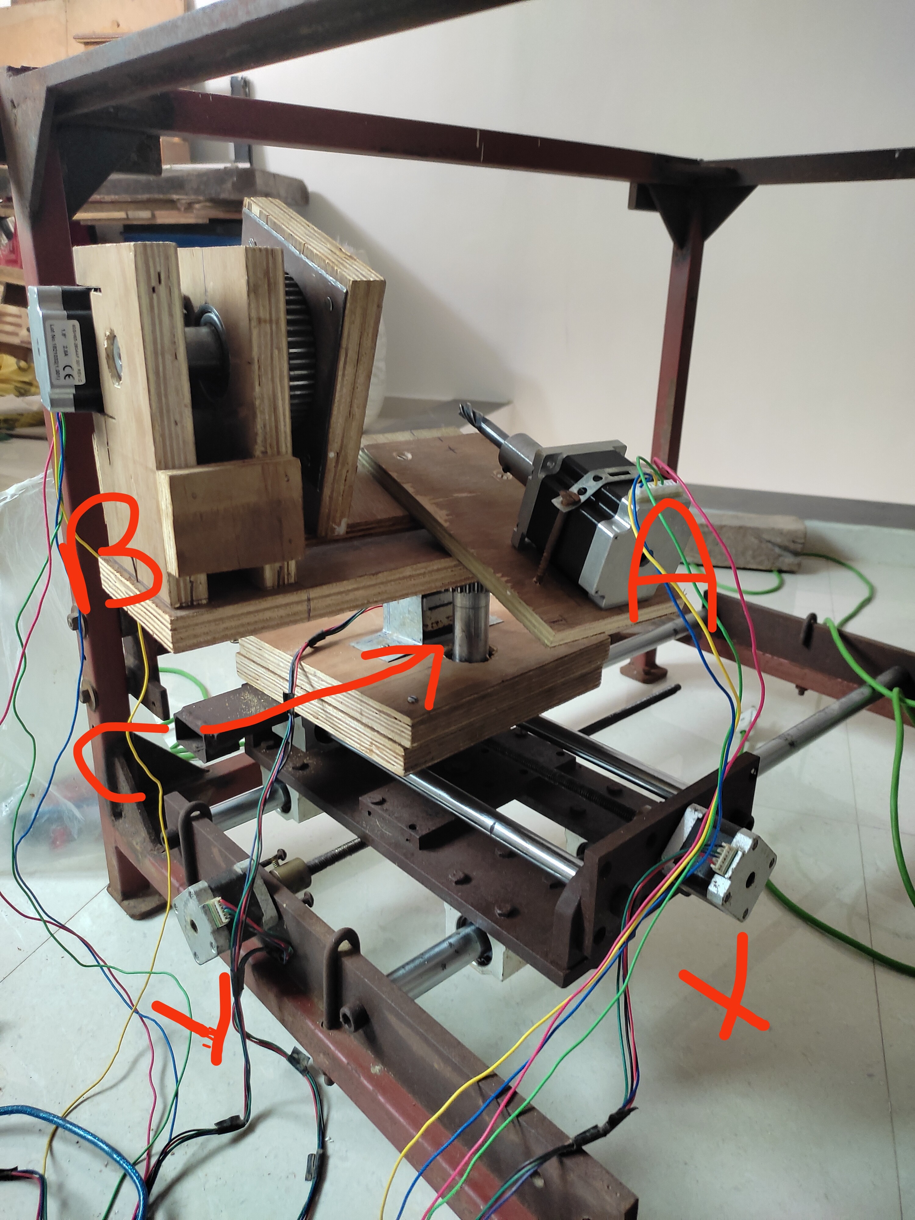

I’m making cnc tool and cutter grinder
So I want to know how to add new 3d model machine in grblgru so I can run machine as I want.
here is photo of basic structure of my machine
Please download the GrblGru manual from my website. In chapter 8, starting on page 87, it describes how to create your own 3D model.
It is important that you choose the right machine type. Compare your machine with the existing ones. Maybe the axis designations are different from yours.
