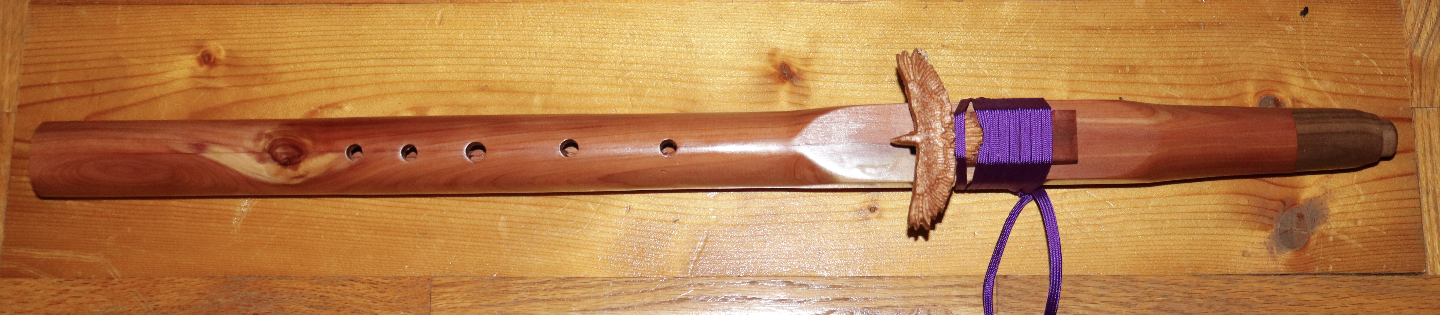

Made a flute with a new design. Not sure if I like it. It is square-ish instead of round-ish. Red cedar and maple construction tuned to F#.
I still haven’t made a totem for it yet. Still deciding what spirit animal I want to put on there. Maybe a dragon or loch ness monster (jk). I have several animal totems designs for the cnc but haven’t decided which one to use for this one.
What are your opinions on the design? Nay or Aye.
I used to make these on my wood lathe.
It’s nice, how does it play?
Thank you. Not sure how to explain it but It sounds a little soft/dull???. Its tuned to F# but not perfect. Not one of my favorites sounding-wise.
I was trying to figure out an easier way to make flutes but don’t like it.

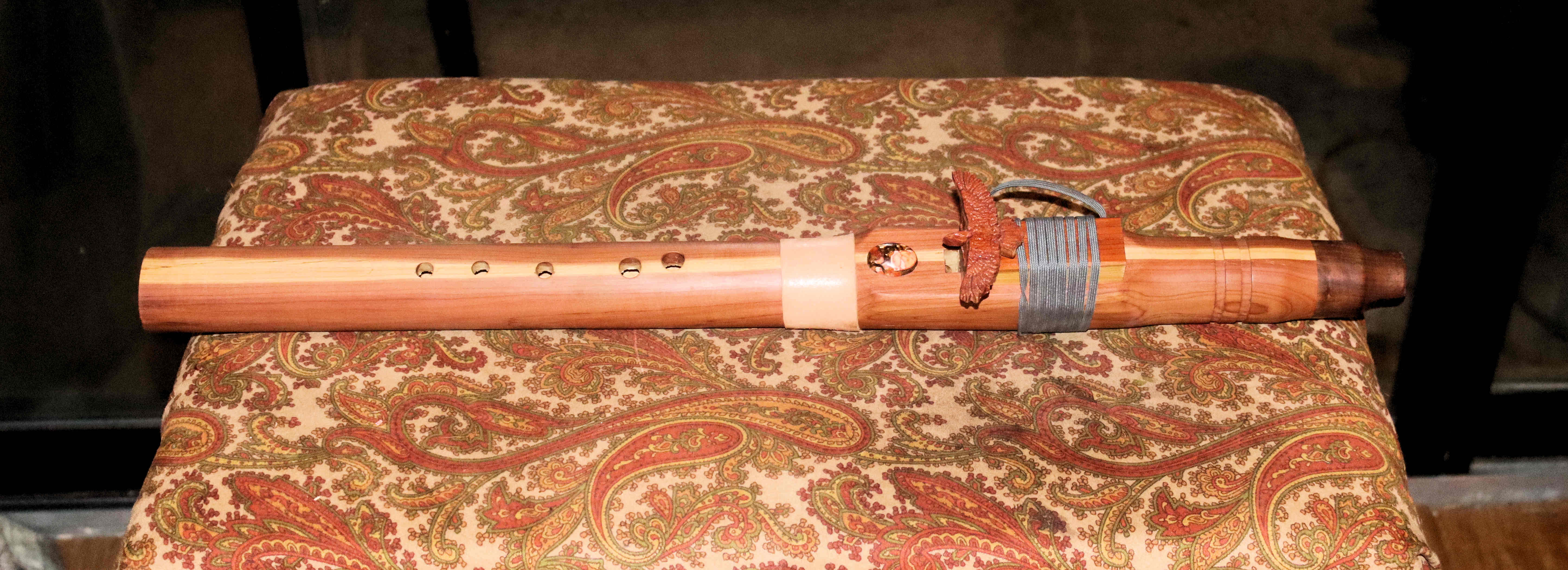

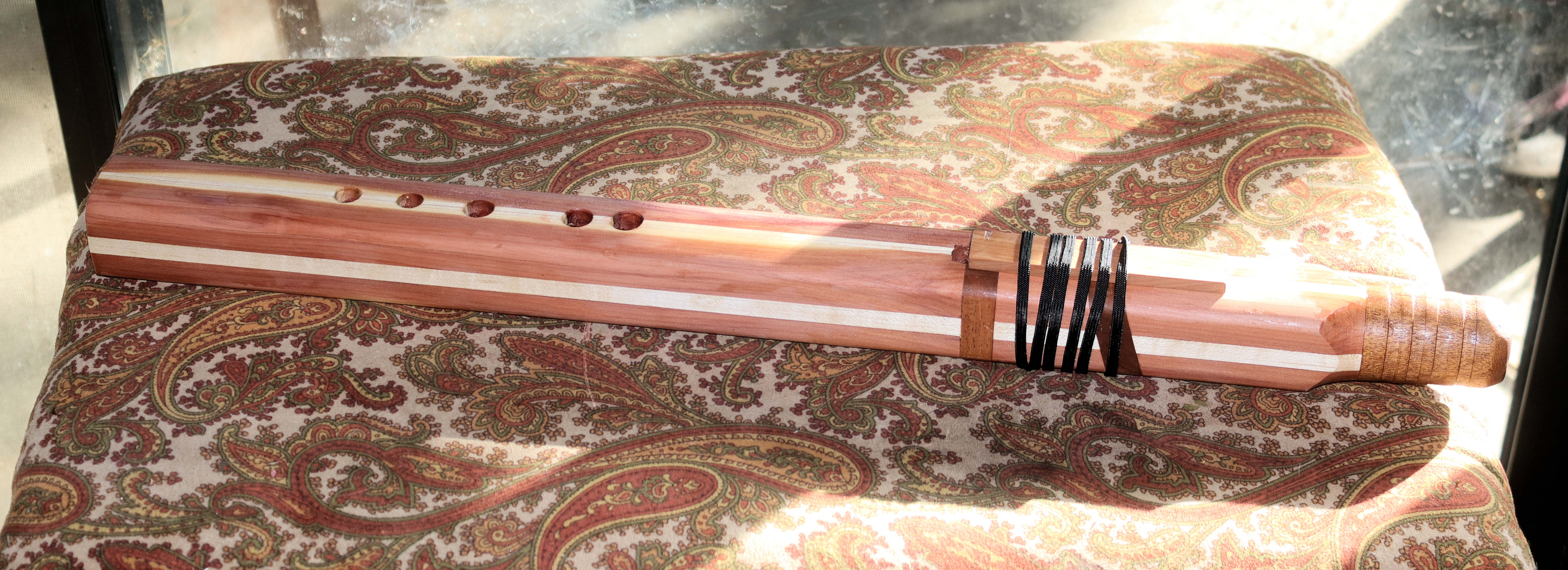

New totem model and three new flutes I made in this series. Eastern red cedar, maple, purpleheart. The totem is cnc carved in purpleheart.

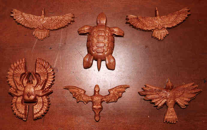

Here are my last batch of totems.
totems in mahogany
Wow! Really nice totems. I like the birds a lot.

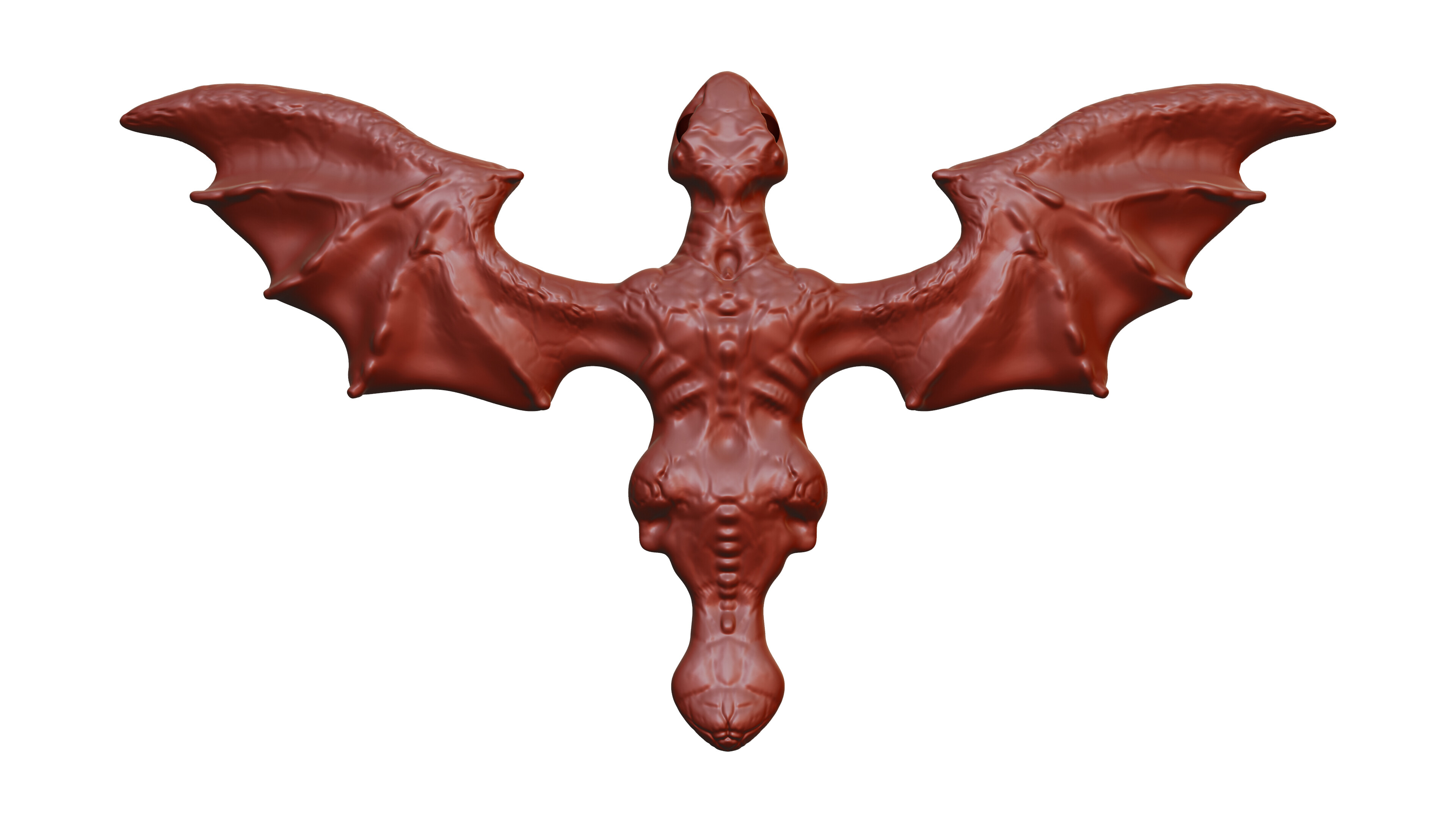

P.S. Still working on new totem designs. I think I am addicted to 3d modeling. :laughing:
