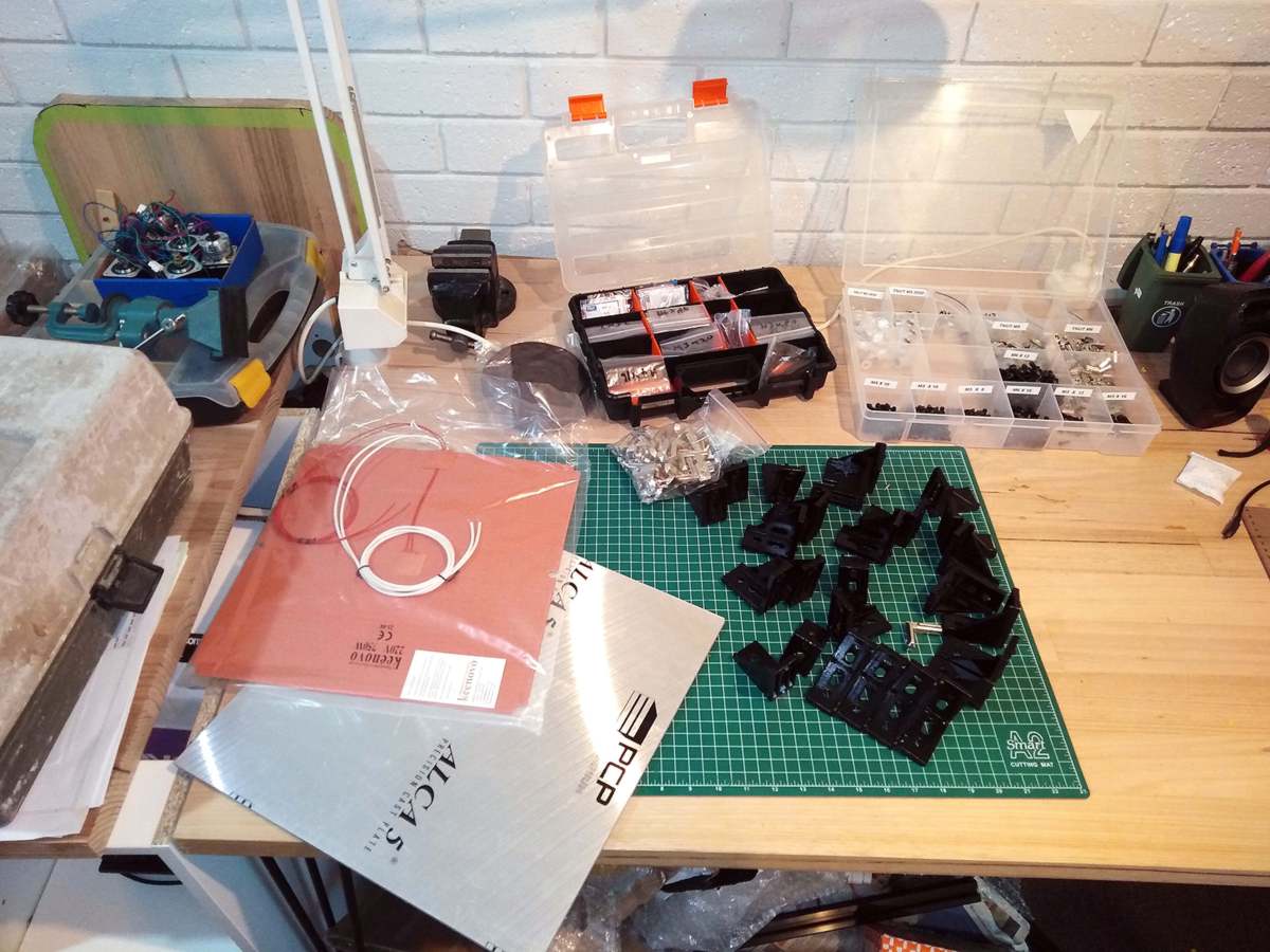

Few more bits ready to go.
Heatpad, bedplate and neatly sorted fasteners.
Linear rails and ball screws. I’ll give these a good clean before I use them.

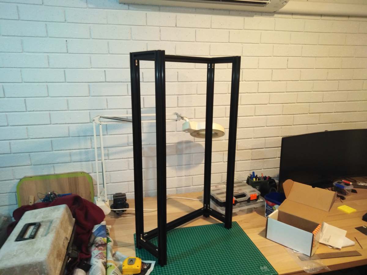

Put a bit of the frame together while waiting for some more filament to be delivered.
This is just the electronics enclosure on the side, stands just on 930mm high.
The full width will be 650mm
Main frame part is assembled It’s going to be BIG!

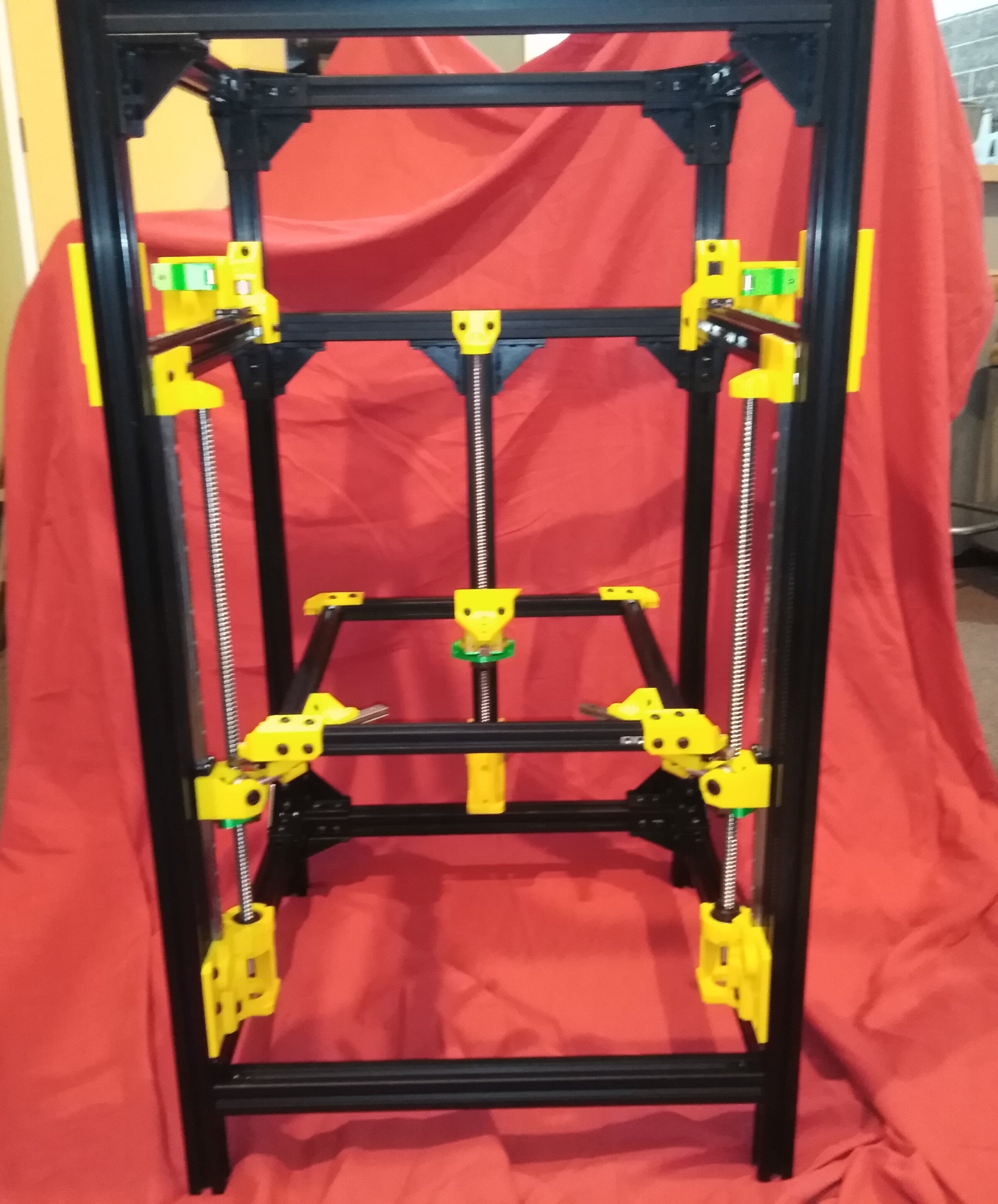

Still waiting for some parts so assembled what I had to make the bed frame. This holds a piece of 6mm cast aluminium, 375mm x 375mm.
Overdue for an update on the Hevort.
Got the frame assembled (mostly) Note to self: buy drop in t-nuts next time!
Had trouble sourcing the ball-screw bearings so a weeks wait for the remaining one I’ve ordered.
I managed to order the wrong size oldham couplers (changed stepper motor size after I started) so another delay there.

Frame is all finished. Still have to mount the bed plate and the motors. Still waiting for Oldham couplers for those.
Electronics will now go in the base rather than an attached cabinet.
