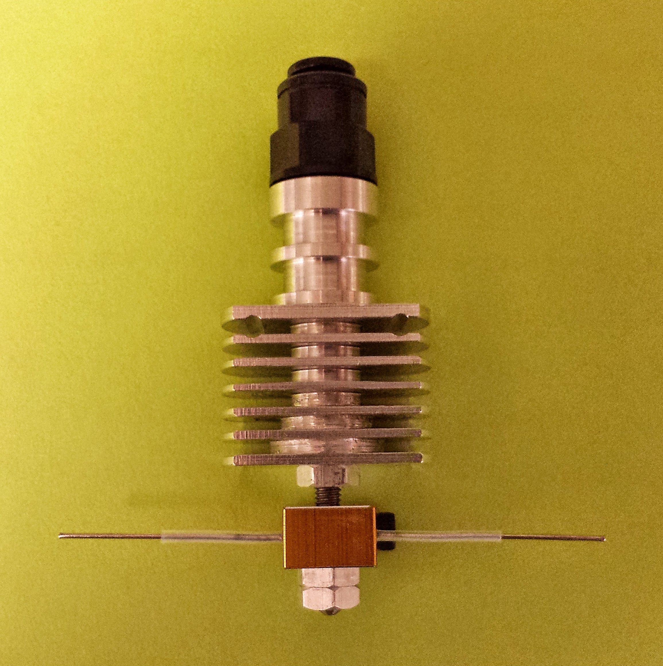

New Prometheus Hot End has arrived! It was well packaged,
It was well packaged, and fit and finish is good. A 5/16" ignition wrench makes tightening the jam nuts easy if you have one handy.
Build in process… I wrapped the heater block in kapton tape and sleeved the resistor leads in teflon tubing to prevent accidental shorts.
I manged to sneeze at the worst possible time and blew the thermistor to Knowhere… after a futile search, new thermistors are on order as the larger epocs won’t fit without drilling the block.

Stepped away for a couple of hours for a bike ride with my daughter and it mysteriously appeared on the floor!! The build resumes!
