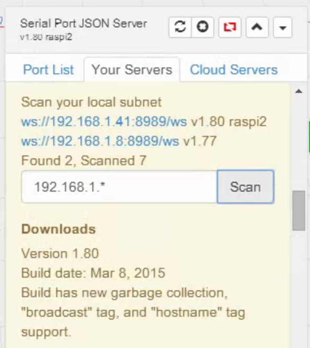

New SPJS v1.80 with better garbage collection (helps solve some of the stalled jobs some folks have seen on slower machines), a new “broadcast” tag to help features like pendants, and the “hostname” tag to differentiate multiple SPJS’s on the network.

Just to clarify on performance on Rpi, in general Rpi works great and has worked well for 99% of folks. However, I’ve got some Gcode files sent to me by some users that do seem to cause stalls but only on Rpi–not any other device. I’ve been in testing mode for the last 2 weeks to see why. If you have basic Gcode then SPJS runs great all the time and on every device including Rpi. When you have Gcode with tiny movements, thus massive processing in/out, this seems to be where you may get a stall, but it’s random and has to do with the randomness of garbage collection. This latest version should help to solve.
