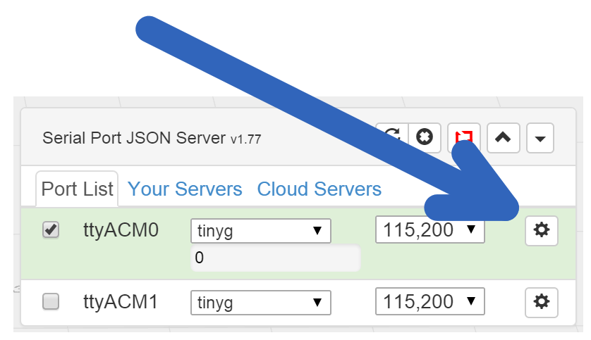

New startup script capability in the SPJS widget. Automatically send any Gcode or other text on open of the port. This is handy on the TinyG v9 where there’s no EEPROM and you have to send your config each time you connect.

John - I wasn’t uber-obvious that the three commands that appeared were “templates” and not executed. After they didn’t happen, it was obvious. I entered a one line script ($xvm=1) and saved it. I had a hard time getting reconnected to spjs (the black reconnect popup was ineffective). After refreshing the whole CP fiddle, I was able to reconnect and it ran.
Does the entered script run on all connections via the identified SPJS? Is there a way to save a script and disable it? I bounce among tinyG, tinyGv9 and G2onDue, so will need unique (and LONG) scripts for each, or none in the case of tinyG.

I sort of assumed this was a SP widget based implementation? It did run with SPJS 1.76, but with some reconnect difficulty
A bit more, I tried it again - just disconnect from SPJS, then wait a bit, try reconnect. It does not reconnect, but I do see in top-middle screen a pop-up with “Serial Port Ajax Error”
