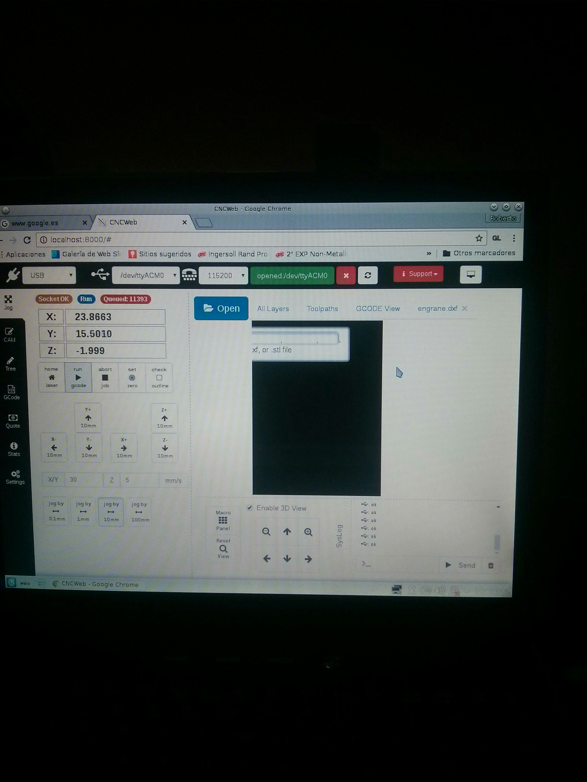

I instaled debían 8 to run cncweb, and I can not see the drawings in the screen. Only a black square.
Webgl is active in chrome.
All is working well, except the black square.
Any idea?

The vídeo chip is Sis M760.
Now is working, I changued in chrome://flags, the first option. Enable hardware GPU acceleration and forget the list of software accelation.
#ignore-gpu-blacklist
I can see the drawings well now.
