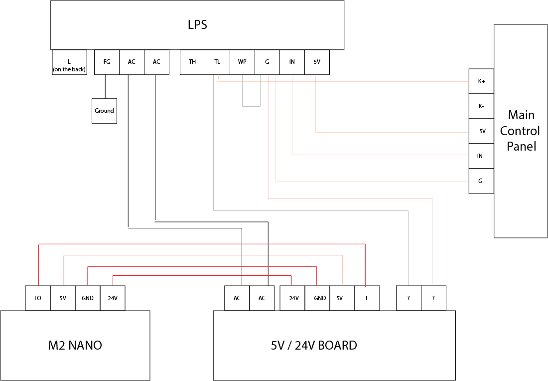

Please explain why your drawings are showing a different LPS than the pictures show???
i just drew this
Sorry, i pulled that off the k40.se site, was trying to figure out how do you wire the ammeter in
I don’t think the OP know the meaning of series or parallel circuits. Seeing what was drawn I don’t believe the OP knows what an electrical wire actually does so this really is more of an effort of literal steps. ie cut the blue wire, expose the copper of the 2 cut ends, connect the copper to the 2 terminals/connections of the Amp meter, etc.
It scares me when I see someone draw a circuit like what was drawn and is inside the electronics bay of a laser cutter.
hahaha… i do understand what and how circuits work… and i drew the circuit on microsoft paint… just because i don’t use fancy software to draw a schematic diagram, it doesn’t mean i’m an idiot.

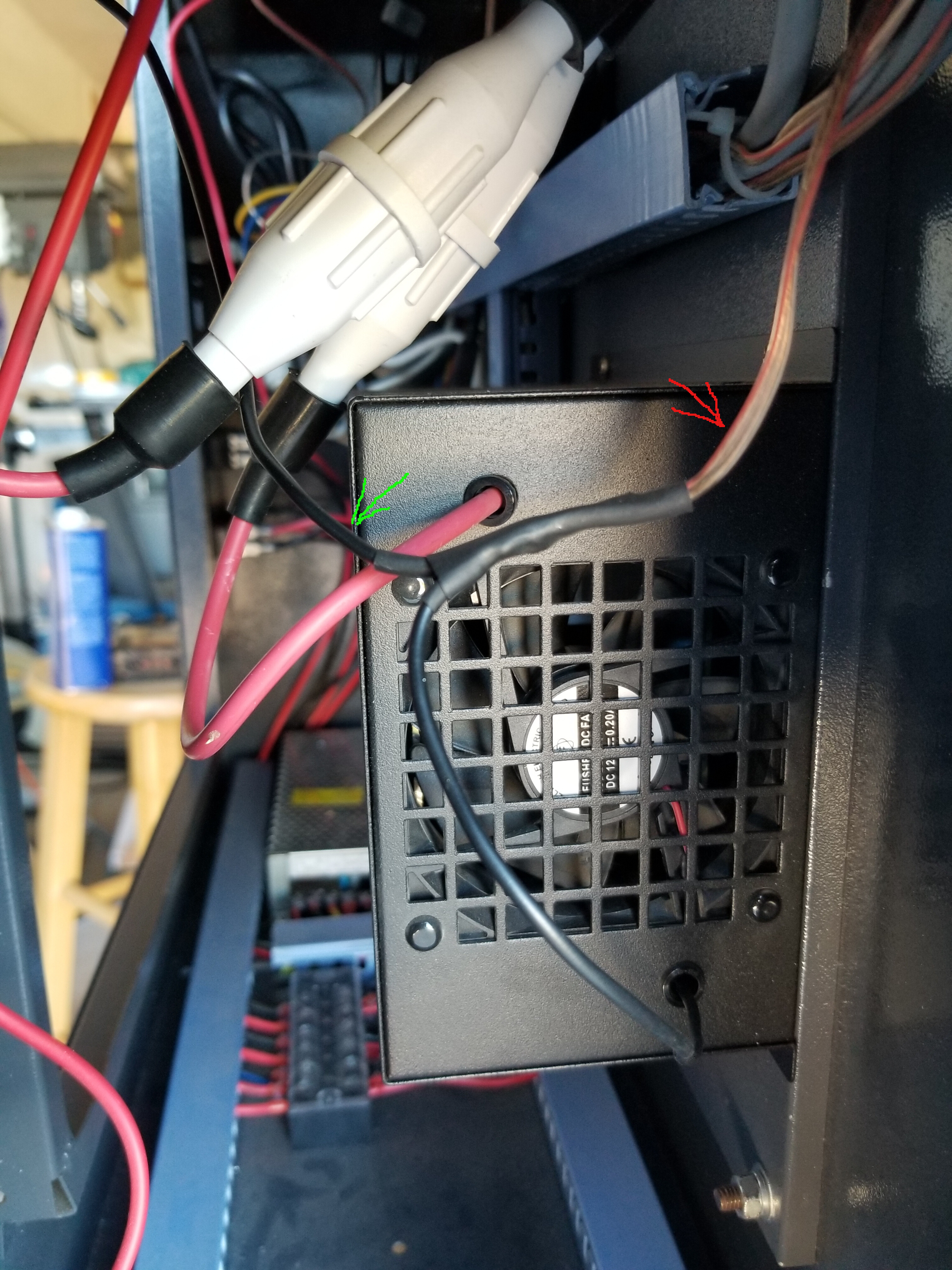

Maybe this will help… The black wire is your blue wire…
Wire (green arrow) comes from cathode to positive side of meter (red arrow).
My ma meter is just spliced in. The side going to the supply is the meter negative and the one from the tube the positive…

This is how you are confusing people (me).
This picture does not seem to be the same:
as this schematic protrays???

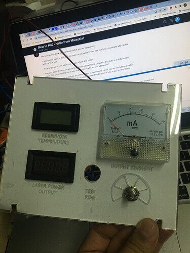

BTW your new panel is missing a LASER ENABLE switch?
No it is not, only thing in the picture that’s connected is the ammeter and the water temperature gauge. The scheme is my reference to what the original wiring and layout is before i hack it all up.
Would i really need one since the original panel did not come with one?
Sorry, my bad… my replies were all over the place and the images that i was sharing wasn’t what my of actual. will try to be clear and concise
Your right I see that your original digital panel does not have one. The digital panels I have seen have one. Evidently another ugly change in that panel’s design.
The enable function is implemented by logic internal to the digital panel.

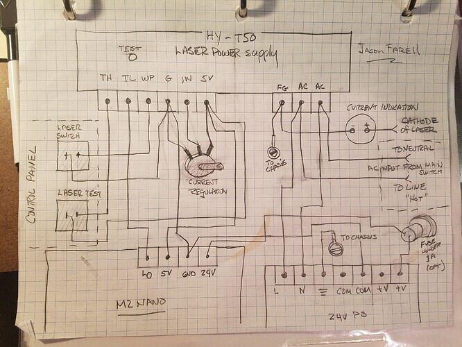

Without the digital panel, you need a function that enables/disables the laser.
Everything you need is on the drawing I gave your for your supply including a Laser Switch (laser enable) and a Laser test both of which you need if you are replacing the digital panel.
I suggest modifying this drawing to show your actual wiring that way we will stay on the same page :).

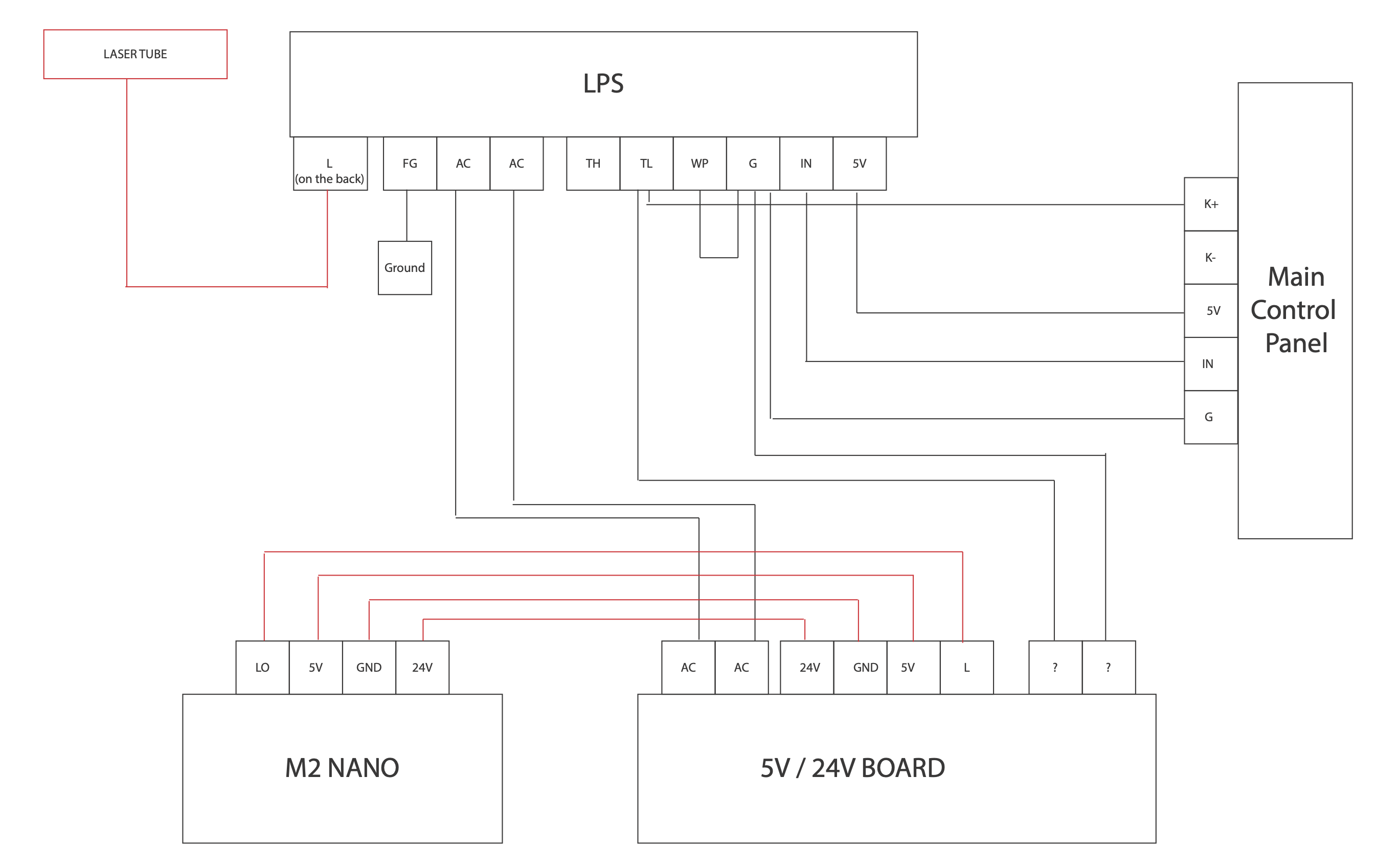

anyway, here’s my wiring diagram that i’ve worked on, haven’t hacked it up yet, but this is what it will be. Appreciate the comments.
Before:-
After:-
Btw, please forgive me if i’m not using the appropriate symbols in the diagram… :see_no_evil:
The way you have it the Laser Switch shorts out the interlock circuit.
The Laser Switch should be in series with the interlock circuit.
The last two connections on the LV (5V/24V) board have ? on them, how do you know where to connect them.
The L signal is routed through the LV board? Not sure why, simpler wiring perhaps?
