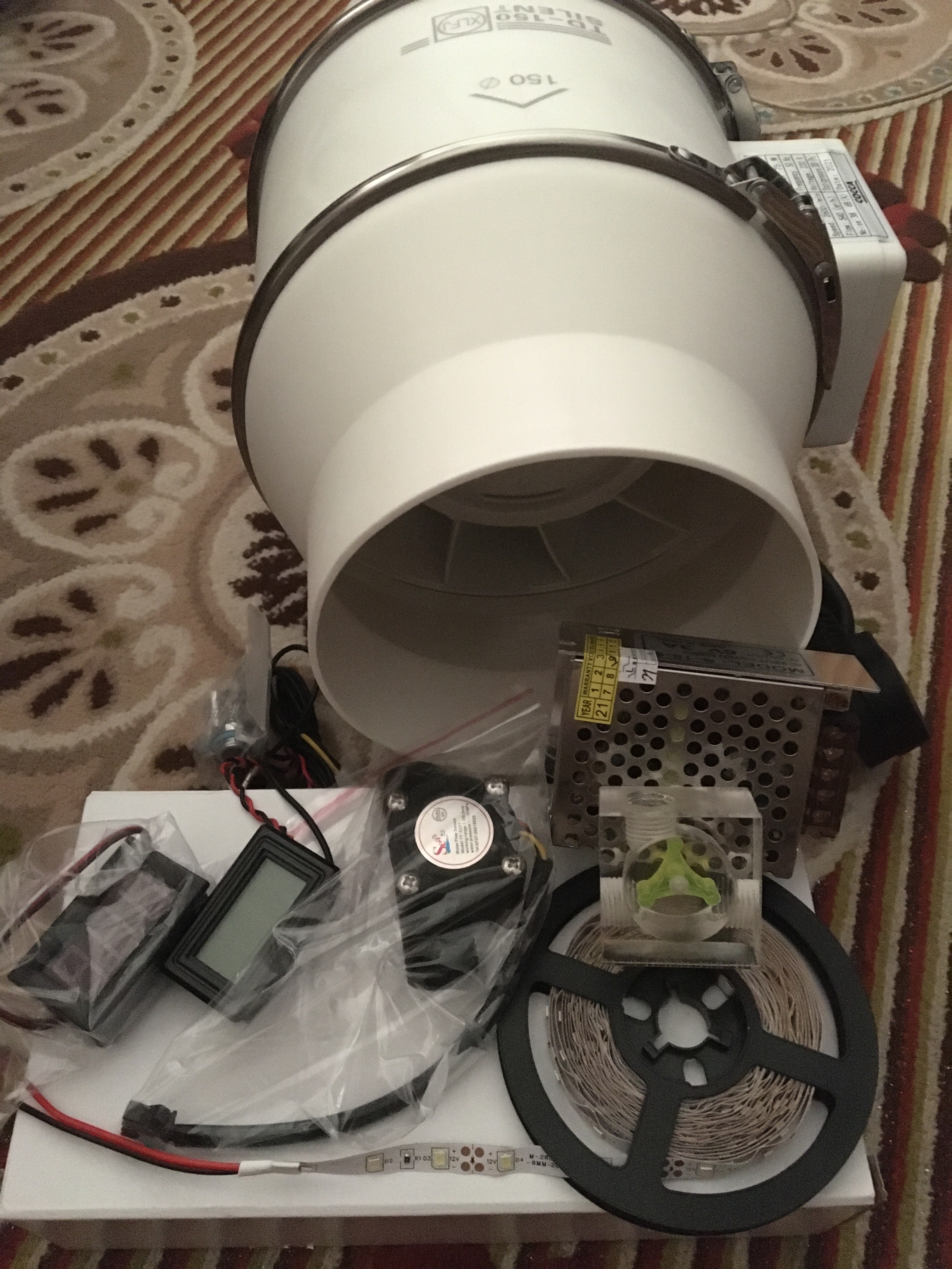

I have also done my due diligence on the machine and have ordered these following items:-
To be purchased (do let me know if i’ve missed out anything important) :-1:t3:
  • Flow Sensor
  • A water pump (waiting to see if the stock pump is any good)
  • A new set of switches
  • Mirrors
  • Lense

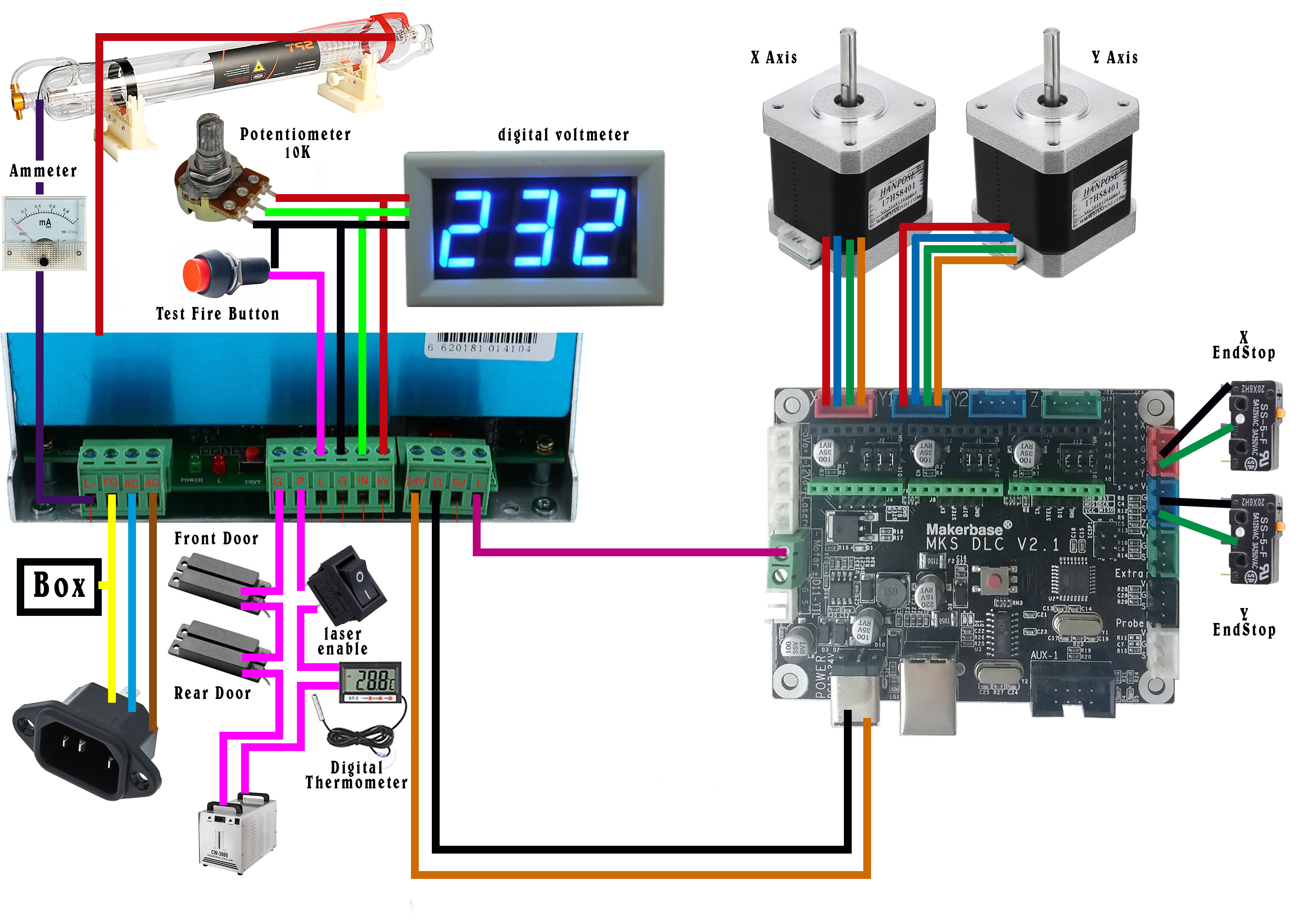

Here is a recent wiring diagram from someone using a MKS DLC 2.1 with a K40.
You might want to test your laser with Meerk40t before replacing the controller, especially if you end up needing vendor support to resolve problems.
I’d suggest considering a 32-bit controller instead of the MKS DLC. That’s an 8-bit controller. If you will be using gocde and especially if you will be cutting any arcs, one of the inexpensive 32-bit controllers would be a much better choice.

Also with regards to the controller, the two that i’m looking at, both of which are 32bit controllers:-

Some goodies arrived today, i got a little trigger happy and purchased a12v and 5v power supply without knowing if my machine comes with a12v psu :rofl::rofl::rofl: if it does, I guess i would have to buy more led light to put around the house… lol
@tomatsu thank you for taking the time for the detailed write up, I guess we’ll have to wait for my machine to arrive first before i make more unnecessary purchases… :sweat_smile::sweat_smile::sweat_smile:

The Flow Meter basic little acrylic box with a wheel that spins to show that the cooling water is actually flowing goes to before the laser tube inlet. Also houses the temperature sensor. Check out this you tube vid
The Flow Sensor connects before the flow meter, and it connects to the interlock… no water, no laser…
@jkwilborn this is what you were asking about right? Just in case I misunderstood your question.
I use a flowmeter that actually shuts down the HV supply rather than relying on having to constantly watch the meter.
I don’t know if this one is permanently out of stock or not but it provides and example.
