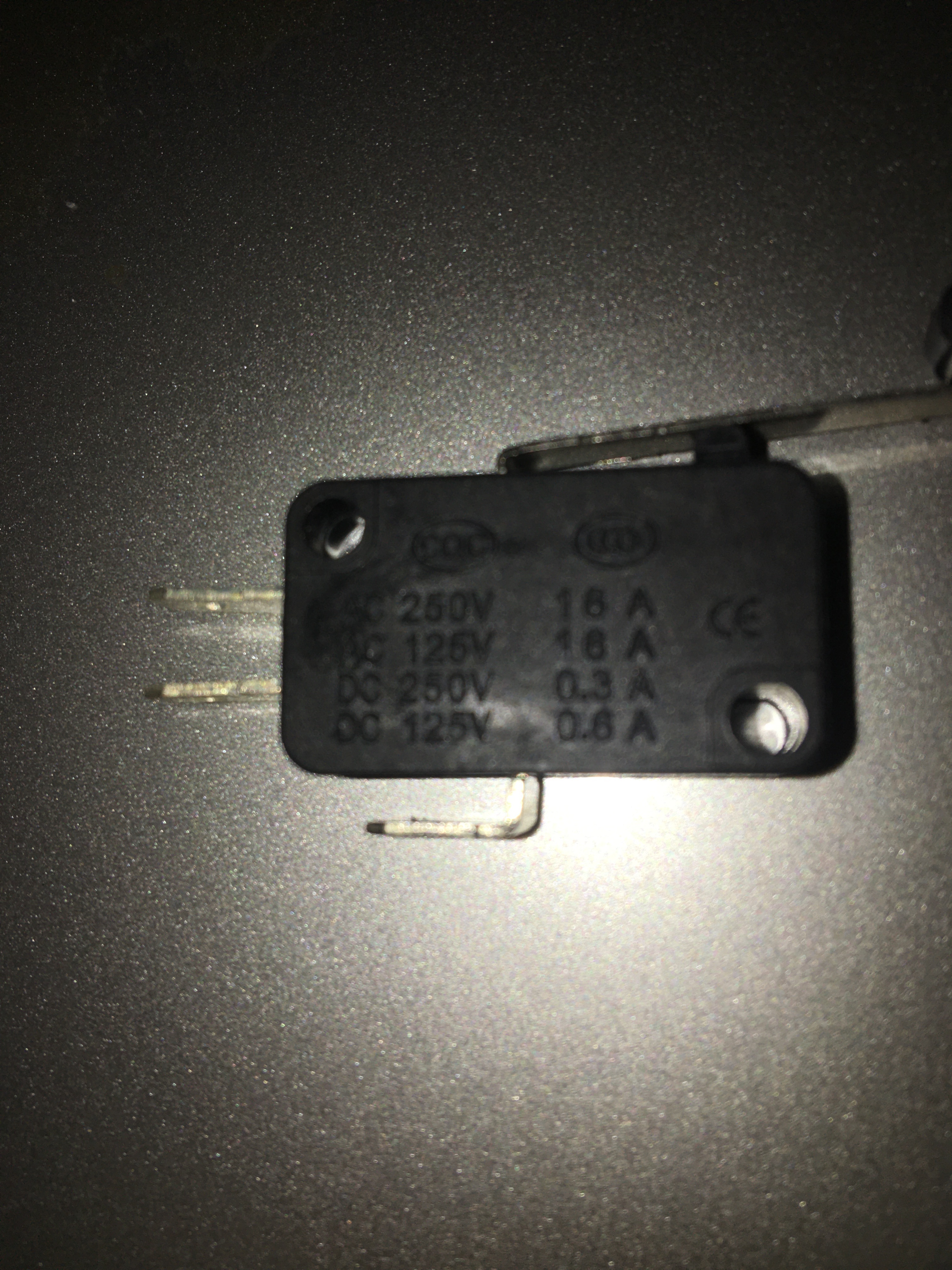

Hi Guys, I’ve got a question, I just realised my interlock switch that I received is rated 15A, 250V AC … is this correct for my machine?
The interlock should be logic level DC. It shouldn’t be on the AC side at all. What you care about is the DC rating (if it has one) but it would be relatively unusual for that rating to be less than 12V. So basically any switch should be fine.
there’s some ratings on the side:
So I’m a bit confused
