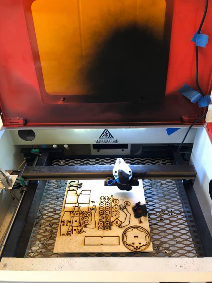

Fire danger!
There is a very real danger of starting fires with the K40 laser. Never operate it without a fire extinguisher nearby.
- Stay present at your laser at all times while operating it. Do not leave it, even for 30 seconds. If you have any urgent need to leave, stop/pause the job first.
- Keep a CO2 fire extinguisher immediately at hand, and use it if flames start. You must install interlocks, and you will depend on them to avoid eye damage when you need to use the fire extinguisher.
- Add air assist and use it. This may “blow out” smaller flames at the focus point before they build into self-sustaining flames
- Keep the inside of the machine clean. Condensed plastic fumes on the bed or scraps of work under the bed can ignite.
