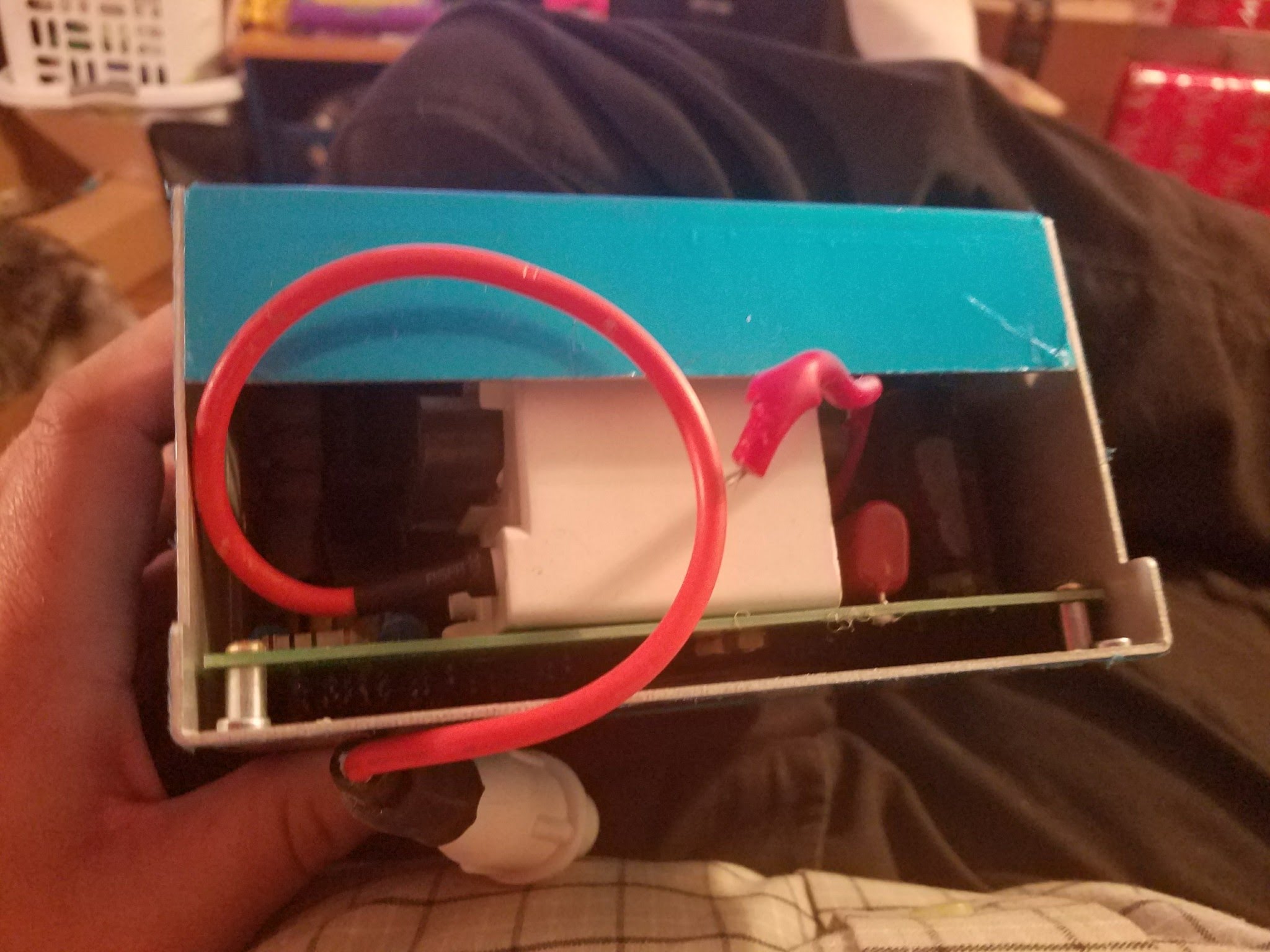

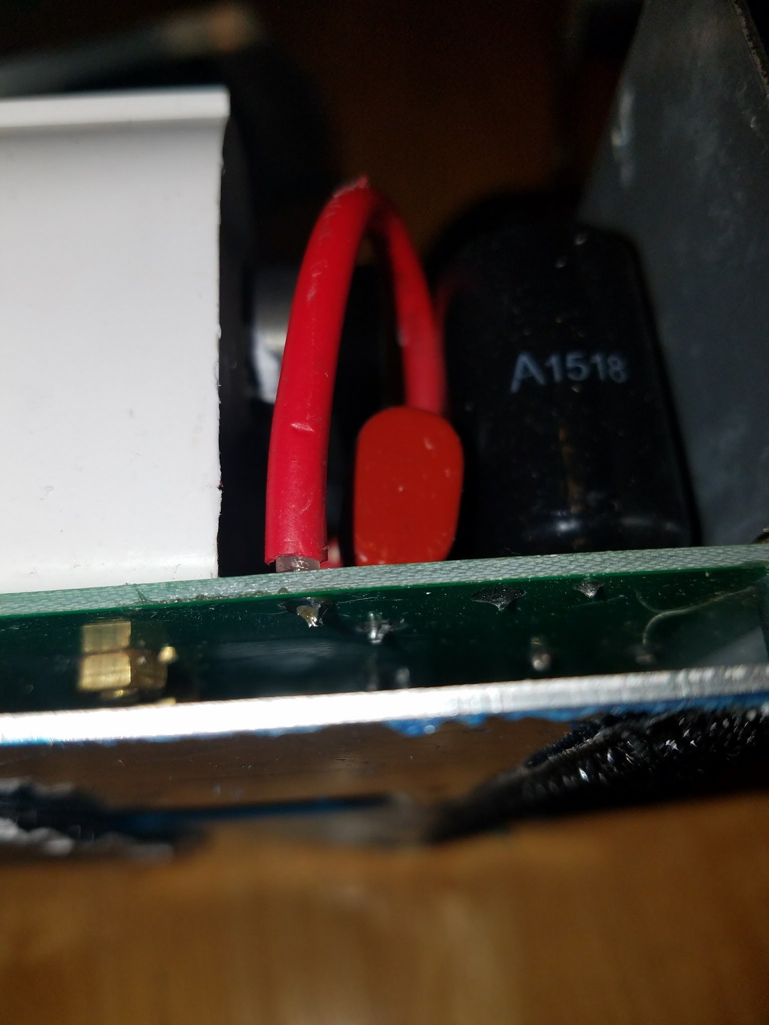

I ordered a brand new one from China off Amazon when I got it there was two wires coming out from the flyback I knew that wasn’t right one had a plug the other was a bare wire so I tried insulating it not sure why it was there hooking it up and it arked inside the power supply and now it doesn’t do anything
I think that second wire (not the HV one) should either be connected on the PCB or it should be connected to ground. Can you point me to the site where you bought it?

But it still won’t fire I’m guessing when I fired it up the first time it took something out I had it insulated with rubber but when I push the test button it arced inside
@jonathon_Hendrickson are you able to return the item. Seems like it was already defect when they delivered. As don pointed out, the return wire from the tube goes to ground. If it has a short on the pcb then it would explain the tick and 3mA. I speculate that you have a short capacitor in the hv circuit. Or two routes on the pcb are too close too each other and the hv circuit takes that shorter route. This can happen when wires throught the circuit islands on the pcb are sticking out too far near each other. See if you can see it arcing under the pcb and clear the space between the arcing points by cutting those protruding component leads. Make sure you discharge the psu and it capacitors first otherwise you’re for a big shock. Let me know how it goes.

As I now understand it the grnd on the HVT was hanging loose when you got it and you tried to insulate it. When you powered it up it arch’d [it would if the HVT ground is not connected ] and now it is dead.
