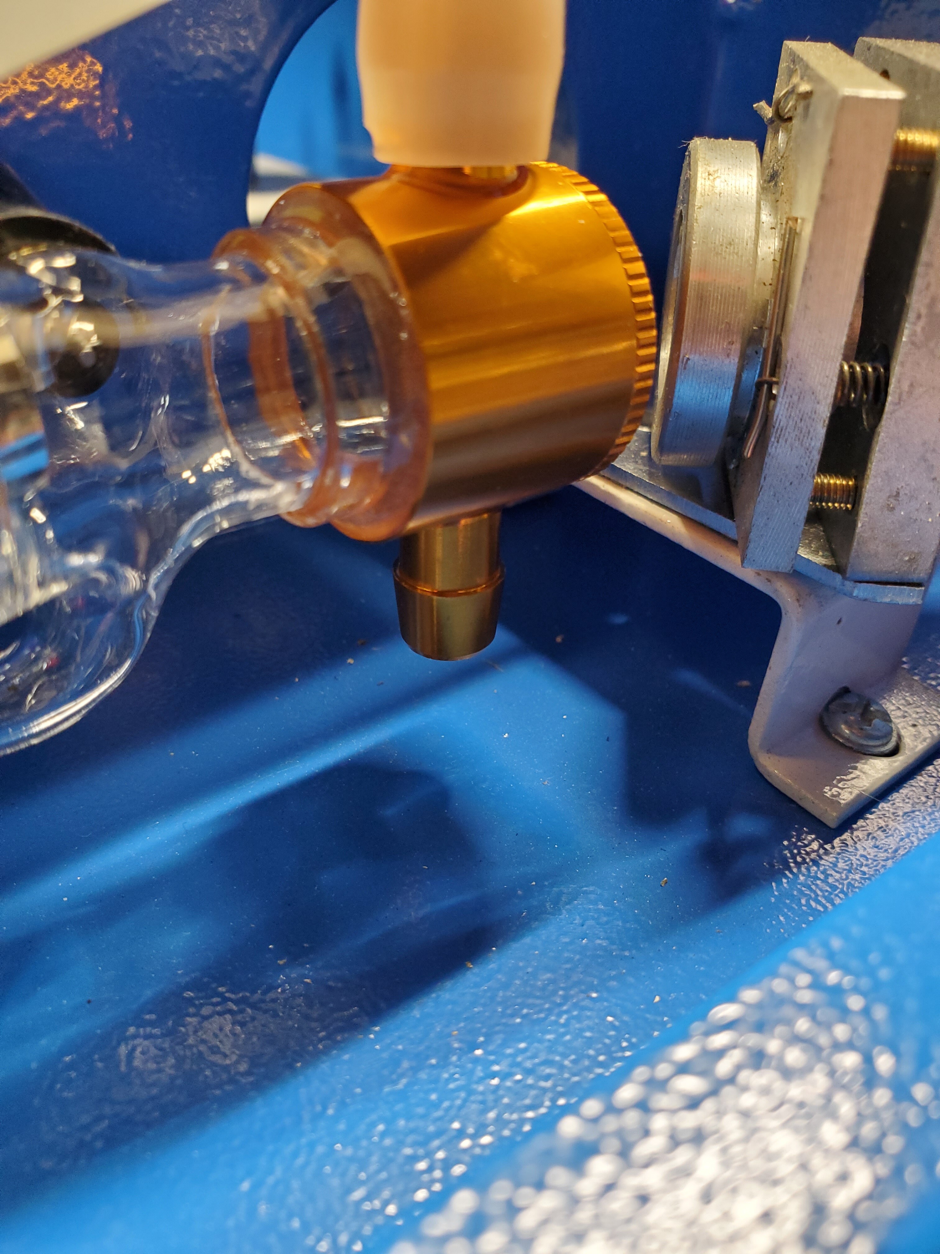

So I have a new Cloudray laser tube. It has a sticker on it that says “this side up”, but when that side is up, the water outlet points straight down and has very very little clearance. It’s tough to tell in the pic, but there’s less than 1/2" between the fitting and the bottom. I’m waiting on tubing to be delivered, so I haven’t actually tried it yet.
So, can I rotate the tube?

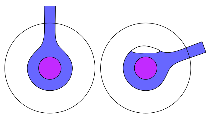

Having the outlet from the water cooling tube point up is the ideal orientation. It lets all the air escape:
You could rotate it, but then you’d have to lift the machine a bit every once in a while to get the air out.
If the angle is only very slightly off, the air should still be able to escape.

No, Inlet is at one end by the HV wire, outlet is at the other end. However, when the tube is placed in the machine with their ‘this side up’ sticker facing up, the inlet is at the top, and the outlet points straight down like in my picture.
I just want to know if I can turn the thing so I can get a tube on the outlet fitting…drilling a hole would be my last resort.

The outlet from the water cooling tube is the one which has to point up:
If the tube is oriented like that, the inlet is usually at the bottom.
In my experience, you can rotate it slightly to help with the tubing connection and still get the air to clear.
