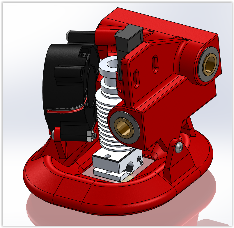

New version of the carriage duct for people to try. Let me know what you think (nice thing is it is an easy swap).
I like this one more because the air flow seems to be more directed at the tip of the nozzle. Pictures of the old vs the new are included for comparison.
Note: Support for the inner face of the duct is built in since it is very hard to support in a slicer. You may need a little knife action to remove it.

Yeah, I noticed there’s going to be a lot of cooling right on the nozzle and heater-block when I saw the cross section. Glad you made it compatible with the existing carriage. Makes experimenting easy.
