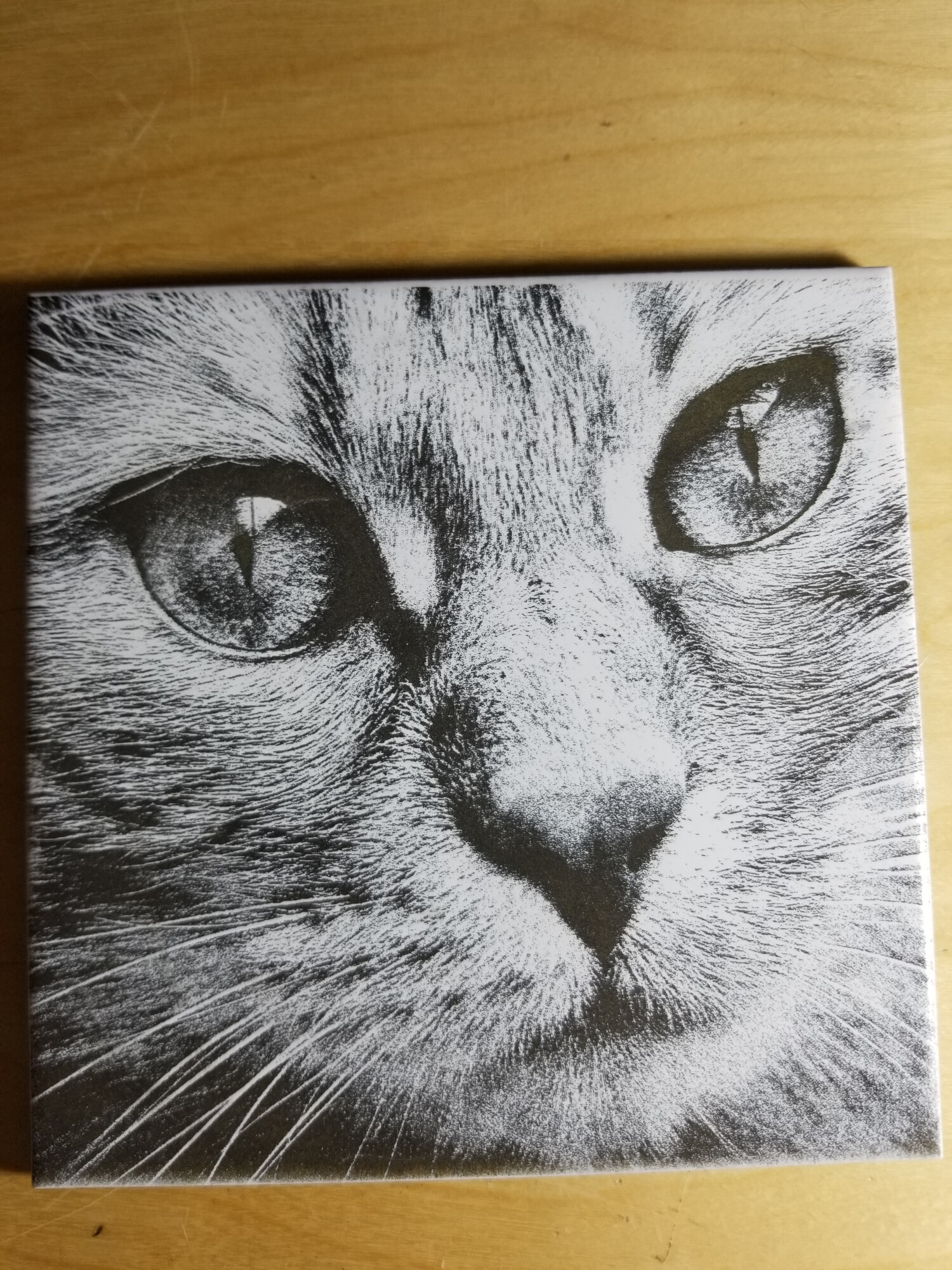

I did one of my tiles with it at 500mm/s @ 15% 508dpi. This is rather fast for most of what I do but I can’t complain too much about the results…
