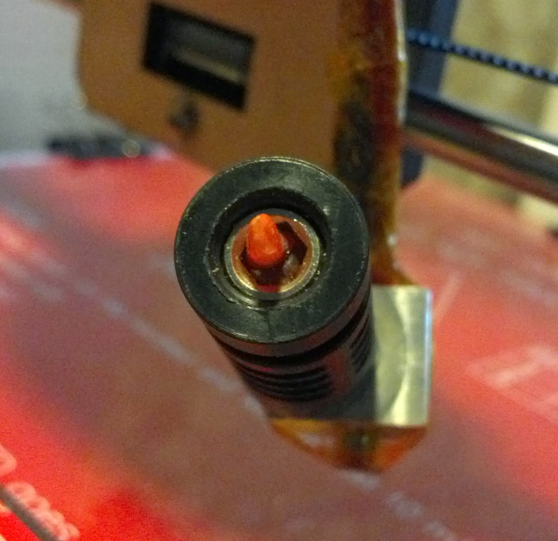

Newbie mistakes galore… On a freshly assembled printer decided to - no, not print something, I am far from that, but at least extrude some plastic, just to see how it functions. Only PLA in house (a couple of shipping mistakes left me without ABS for my initial tests, such a pity). Took 3 mm PLA, stuck it in - worked for a while, to my enjoyment, I fiddled a bit with the extruder calibration and then… the whole thing got stuck, no, STUCK. Quick googling (always done afterwards, otherwise it’s not fun!) shows the PEEK thermobarrier shoulda been severely cooled to prevent PLA from expanding in glass phaze, which is what happened to me. Just look at it - photo shows top of PEEK, where the PLA has even overflown a bit of the retaining screw…
Now the question is - how do I get all this PLA out of the PEEK thermobarrier? For the moment I am re-running the heater at 190 degrees C, in hope that after a while the PEEK will heat up evenly enough to make the stupid plastic a bit less solid. But it does not seem to happen - what else? Oven, heat it all in hope to catch it before the PEEK overheats? Drill bit, removing PTFE liner et al?
I am sure I am missing a trick here…
aaaand as is usually the case, the matter solved itself right after - oven at 200C and a wooden stick were all it took. Back to experimenting!
You can also run your hot end at ABS temperatures and push the plastic through with the same wooden stick, but the oven sounds like a more effective solution
I only count 4 flutes in that body. Meaning this is likely one of those knockoff J-heads. Don’t use clones: http://jheadnozzle.blogspot.com/2013/11/is-j-head-real.html
@ThantiK 4 flutes indeed, but I learned the difference only earlier today when I stumbled on that same post you mention. But then, this particular clone is not that bad - inner PTFE present, PTFE ring between heater block and PEEK present, even the inner nut (sorry for my ignorance of the correct term) that as I understand serves to keep the PTFE tube in place - even that is present. So, it’s not that bad, even though, of course, it’s far from the real thing.

the problem was that PLA melted all the way up to the entrance of the PEEK tube - and no matter how I tried I could not get it hot enough to clean it all. An oven heats it all up much more evenly.
